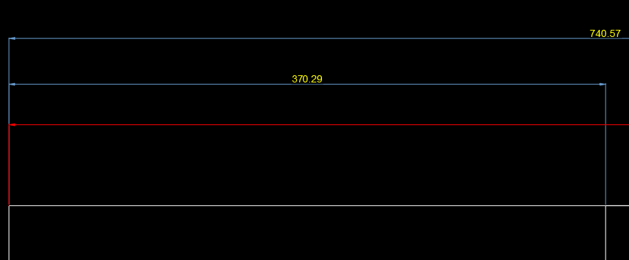

francine2013 Posted November 3, 2021 Posted November 3, 2021 Hello, I'm looking to find a way to align multiple dimension text. The reason is that I'm using the Viewport and all dimension aren't visible. Attached are 2 drawings explaining my problem, to change the position, I manually copied the coordinates in the properties and inserted them in the dimensions I wanted to change. Is it possible, by using the text position X or Y coordinate, to modify by lisp the other dimensions? I have started the routine from this forum but I don't know how to make it work. I have no idea how to program lisp. Can somebody help me please. Many thank DimensionAlignManualy.dwg Dimension.dwg DimTextMove.lsp Quote

francine2013 Posted November 4, 2021 Posted November 4, 2021 Hello Bigal, I think your proposal is not what I'm looking for. When I'm working on the model space I would like to move the dimension text (in red) to the same x position as the visible dimension Quote

francine2013 Posted November 5, 2021 Posted November 5, 2021 I found a lisp on the Autodesk forum but it works only with horizontal dimension. How to change this lisp so that it works for both cases? Autodesk Forum : https://forums.autodesk.com/t5/autocad-forum/lisp-routine-to-slide-dimension-text/td-p/5189789 tt.lsp Quote
francine2013 Posted November 5, 2021 Posted November 5, 2021 this is what I'm exactly looking for but I can't get the lisp to work, the DTA command doesn't appear Quote

francine2013 Posted November 6, 2021 Posted November 6, 2021 Gile solved my request with a lisp at the end of the following page: https://cadxp.com/topic/53420-aligner-les-textes-de-cotation-en-modifiant-les-propriétés-des-coordonnées-du-texte/ Quote
