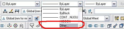

1. Select which line's you want dashed.
2. in drop down linetype menu click Other

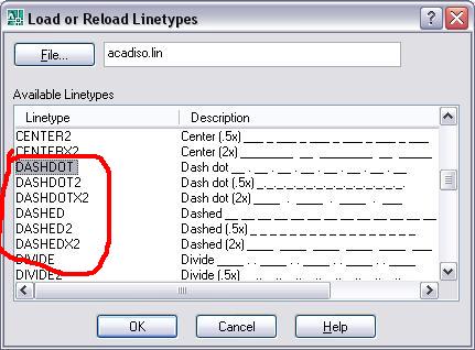

3. When you get the dialogue box click Load
4. Select which type of dashed line you want
5. Click OK

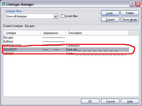

6 Highlight Selected Linetype
7. Click OK.

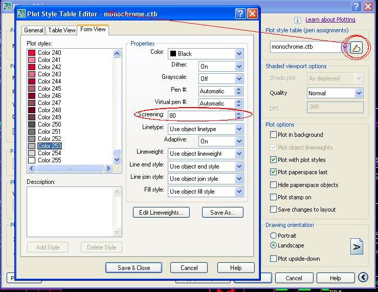

Im not sure also if while drawing in CAD when you say greyscaling of lines, or during prinout. but for printing, greyscaling of lines is achieved in the plotstyle table manager.
Toggle a color you want to greyscale and adjust its screening to about 90 or less
