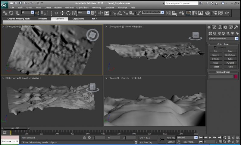

EDIT - Found the stack, with the plane, the displace and the UVW mapping. The parameters for "plane" level are as follows (my parameters in 3DS max 2011):
--length: 219.694;
--width: 252.079;
--length & width segs: both 160;
--render multipliers: scale & density: 1.0;
--total faces: 51200
For the displace level, parameters are:
--strength: -33.986, in the book's tut it's -33.98 - why?
--decay: 0.0;
--blur: 2.1, just as in the book. Decay isn't mentioned, why isn't it?

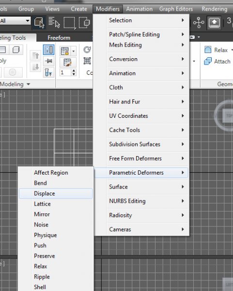

Ok, I selected one of these items - it was plane 02, tut says to Select Plane 02, go to Modifier > Parametric Deformers > Displace to apply the modifier (to Plane 02).
I got as far as getting plane 02 to show up in my viewports (Front, top, Left/Right views) clicking on Modifier, but I cannot find the Parametric Deformer > Displace in the menu - where, in my version of max, is the equivalent to this?
As the book stated, you can find it in the "Modifiers" menu, as shown in the image below.

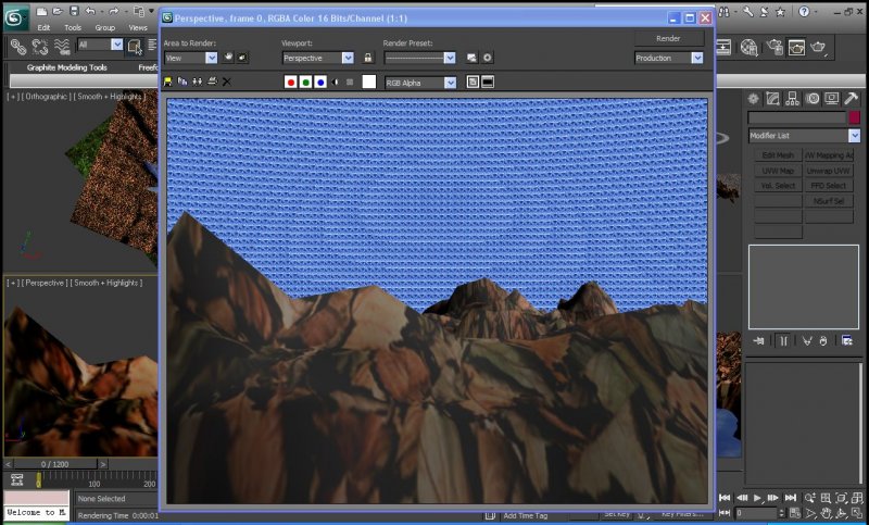

Using the tut 3.1, I'm trying to get the clouds2.jpeg bitmap from my max\maps\skys directory to create the sky background but although i can find the maps directory, i cannot find the skys directory, also my sky render looks more like a sky that's made up of fish scales instead of a real sky. What am I doing wrong and how to I fix this?
EDIT - Here's the screenshot of this render:
Since I couldn't go any further in this tut, I started the next tut (Philly book) shows how to create the jail cell-block (to be another thread, if necessary) - but I'd like to finish this tut first, and then do a scene of my own using what I learned from tut 3.1, then after that, go to the next tut (jail cell-block).
Your rock texture is way too big and your sky texture is way too small. You're going to have to learn how to apply and use UVW modifiers in order to get your textures to behave. I'm not sure if I have already posted this link for you, but this tutorial explains the basics of UVW mapping pretty well: http://waylon-art.com/uvw_tutorial/uvwtut_01.html
How did the book tell you to do the sky? Is it a texture applied to a flat plane or is it a background environment map? Either way, you're going to have to learn about UVW mapping and make adjustments to the size and tiling of your textures in the material editor and in the UVW mapping parameters.

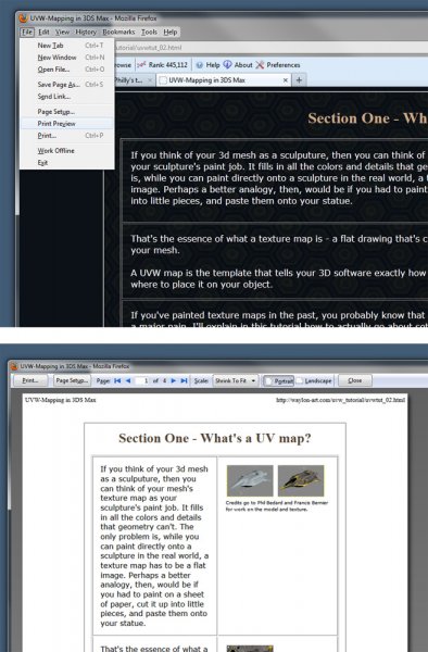

Thanks for the link, Cad64. Is there any way to print out these tuts without getting that back background (and using up a lot of black ink) in the printouts? Maybe save it as .pdf and print?
When I print to pdf directly from Firefox, I get a white background with black text, see below.
