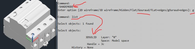

What -shademode do you have set?
If you type List and select one of the parts - what does it say?

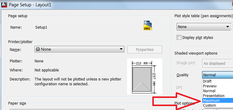

Do you have your plotstyle set to print shaded views?
You will probably have to change some colors and Imprint the text if you want it to look more realistic like the photo.
Edited by JD Mather
Not trying to be mean or rude but it sounds like you really don't know AutoCAD. I just downloaded the part from your link and opened it. That is the default view for Layout 1. You will need to adjust or set your own view with the Visual Style you want to print with. It also looks like the model does not have any materials applied to it either. This is for the dwg file so I am not sure about the file types that you can download. But if not you will have to apply materials and finishes to the model. It shows you have AutoCAD 2012, did you install the Inventor Fusion app from the cd? If not you can download it and use it for the next year until it expires. You should be able to add materials and color in this but it is not so easy for a beginner.
