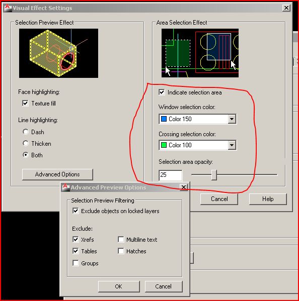

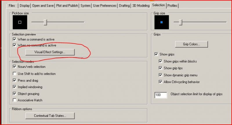

You can control the VISUAL EFFECT SETTINGS options thusly,
enter OPTIONS at your commandline > ENTER
click on the SELECTION tab to access display controls as shown in the image, which is not 2007, but
should be reasonably like what you will see.
