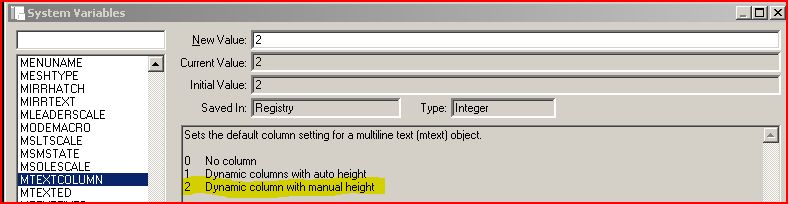

Thank you for the response Dadgad, this is however not exactly what I'm after. I would rather that the text box width and height was defined by the way I drag my mouse as opposed to entering width and stuff as it used to do in older CAD versions I've used.
MTEXTFIXED=1 (fixes overly large MText editor).
Then your best bet would be the DYNAMIC column style, I think,
and try MTEXTCOLUMN value of 2.
^ Thanks a lot. this has solved it!

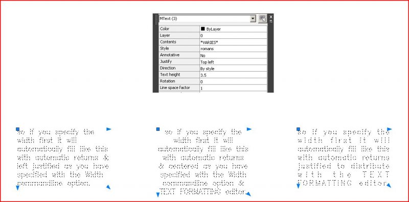

On a similar note, what option would I need to enable/change to make the defined column width (which I manually done by double clicking the ruler in the mtext editor to expand the column size to fit the text) default dynamically like that shown in TEST01. TEST02 is what it looks like for me before doing that (and obviously the length of characters inside is variable and will change).
I think you want MTEXTCOLUMN set to 2, so you can still adjust the height manually if you wish,
as I see you have stretch grips for height showing.
In the image I have done the MTEXT style 3 different ways, they all have had the default WIDTH defined at the commandline
and will include automatic returns while entering text, but they are still reconfigurable with the grips should you need to.
Or you can do it within the COLUMNS commandline option
specifying either a static or a dynamic width, and defining it there, in which case it will remain the default, unless you change it.
Dynamic columns are pretty cool, easily reconfigured by dragging the grips.
