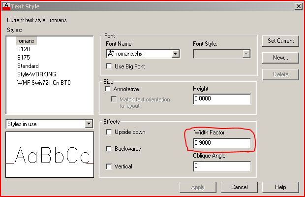

Dadgad Posted August 10, 2012 Posted August 10, 2012 Welcome to the forum. I would suggest that you set up your current TEXT STYLE defined WIDTH as.9, and include the TEXT STYLE definition in your default .dwt template, assuming that you probably use one. Are the texts which you are copying annotative? In model or paperspace? You should be able to select all of the TEXT items, I would use my QUICK PROPERTIES palette to filter select those, and confirm, or adjust all of their STYLE settings to be your desired STYLE. Quote

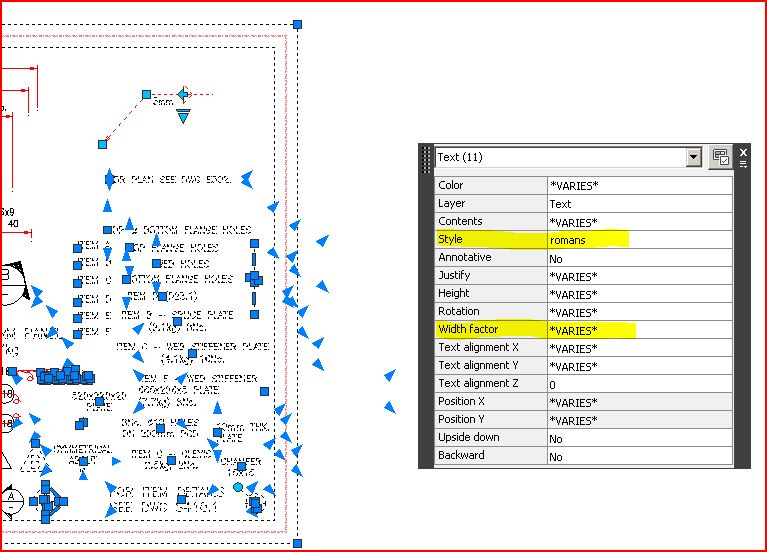

Dadgad Posted August 10, 2012 Posted August 10, 2012 There is no way to do it in OPTIONS, nor with system variable settings that I am aware of. Like I said in my last post, I would change the STYLE or the WIDTH in my QUICK PROPERTIES palette as shown in the image. My guess is that if you just change the STYLE to match the one in your drawing, that the width issue will be resolved without further heroics. I suppose you could create an ACTION MACRO to do this with the ACTION RECORDER in your right click shortcut menu, that would be quite simple, or add a lisp to your startup suite to do it. I would probably still do it as shown, as it only takes a second to do it this way. I understand full well your frustration at having to do anything at all, as you did not previously have this issue with 2009. Quote

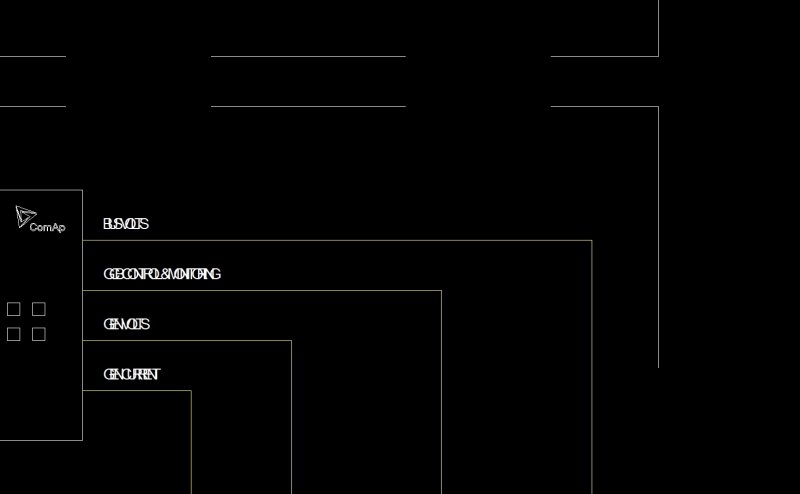

SLW210 Posted August 10, 2012 Posted August 10, 2012 Can you post a drawing with text that gets "squashed"? Quote
G-Man Posted August 13, 2012 Author Posted August 13, 2012 Can you post a drawing with text that gets "squashed"? This is an image of the squashed text problem. Quote

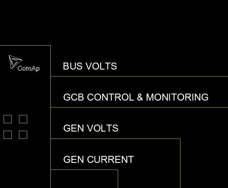

Alex Moiceanu Posted August 13, 2012 Posted August 13, 2012 Hi G-Man. I opened your dwg file but on my PC, I couldn't find a problem with the texts. Here is a screenshot of your drawing... Quote
G-Man Posted August 13, 2012 Author Posted August 13, 2012 Hi G-Man.I opened your dwg file but on my PC, I couldn't find a problem with the texts. Here is a screenshot of your drawing... Yeah it worked on my previous package AutoCAD 2009 lt, and i have never had a problem on previous machines either. I did swap computers so it may be related to a hard ware issue. I just dont know? Thanks Quote

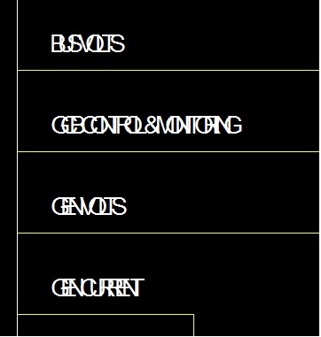

G-Man Posted August 13, 2012 Author Posted August 13, 2012 Yeah it worked on my previous package AutoCAD 2009 lt, and i have never had a problem on previous machines either. I did swap computers so it may be related to a hard ware issue. I just dont know? Thanks This is a screen shot from my comp. Quote
irneb Posted August 13, 2012 Posted August 13, 2012 ...I would suggest that you set up your current TEXT STYLE defined WIDTH as.9, ...Be careful of this. I'd only use it if I use a SHX font. The TTF fonts tend to go a bit screwy when you start sqashing them with width factors. E.g. instead of making an Arial have a width of (say) 0.8, I'd rather just use the Arial Narrow with width 1.0 - the text looks and prints much better if you use the later. Here is an example of a problematic file. [ATTACH]36508[/ATTACH] Thanks for the assistance I also don't see this happening on my PC. All I can think of is that there's something wrong with your PC's fonts. Perhaps some alternative Arial.TTF which doesn't work correctly with ACad. Try reinstalling the Arial.TTF by copying it from your Windows Installation Media into C:\Windows\Fonts (overwrite if prompted). Otherwise it "might" be a graphics card issue, but this is a long-shot. Though I'd still try to upgrade/downgrade the drivers to adesk's recommended version. Also try turning hardware acceleration on/off - for some cards it's better to have it on, while for others its better to have it off. Quick way to check if it is a GPU issue, does your prints also show the text wrong? Quote
