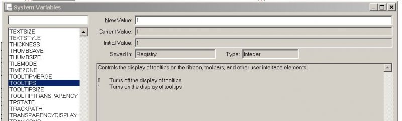

Dadgad Posted August 5, 2012 Posted August 5, 2012 Welcome to CADTutor. There are another set of system variables dealing with tooltips, four of them, as shown in the image. I believe you want to set your TOOLTIPS variable to 0. Were you able to find the MANAGE ATTACHMENTS button in the Additional Options section which you access through the GO ADVANCED button in the lower right hand corner of the reply window? Quote

ReMark Posted August 6, 2012 Posted August 6, 2012 Remove the checkmark as Dana mentioned in Options > Display > Show Tool Tips. Then click on the APPLY button at the bottom of the window. Problem solved. I would also suggest that you disable the option to Show Rollover Tooltips as long as you are there since you obviously don't need that distraction as well. Quote
SLW210 Posted August 6, 2012 Posted August 6, 2012 ReMark said: Remove the checkmark as Dana mentioned in Options > Display > Show Tool Tips. Then click on the APPLY button at the bottom of the window. Problem solved. I would also suggest that you disable the option to Show Rollover Tooltips as long as you are there since you obviously don't need that distraction as well. None of those will prevent the tips from showing in the OPTIONS dialog box. Quote
ReMark Posted August 6, 2012 Posted August 6, 2012 Are you sure? I believe the first one will. The second one is definitely for working in a drawing. OK...a quick test using AutoCAD 2012. You disable Show Tooltips and it does kill the balloon even in the Options window. Quote
SLW210 Posted August 6, 2012 Posted August 6, 2012 ReMark said: Are you sure? I believe the first one will. The second one is definitely for working in a drawing. OK...a quick test using AutoCAD 2012. You disable Show Tooltips and it does kill the balloon even in the Options window. You are correct, clicking APPLY does wonders for this. Quote
