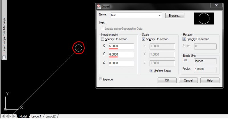

jimbobjewel Posted August 7, 2012 Author Posted August 7, 2012 i have gotten to a stop where im have a little problem. try n 2 insert the tree s that i have into a block. i am choosing the block insert tab that brings up the block page, i select the tree and go and type in the x coordinates & the y coordinates the select ok. at the point the block page goes away but nothing is inserted at the coordinates. does anyone know what i am do n wrong. i will keep look n and try n Quote
ReMark Posted August 7, 2012 Posted August 7, 2012 (edited) Maybe you are zoomed too far out to see anything inserted. I did a quick test using AutoCAD 2012 and it worked for me whether I specified the insertion point inside the INSERT dialog window or I specified it at the command line. See example below. Edited August 7, 2012 by ReMark Quote
jimbobjewel Posted August 7, 2012 Author Posted August 7, 2012 i put a line on the drawing using the coordinates listed and as i figured it was on the drawing. the pulled up the window as u suggested and the x,y coordinates were the same 1421083.84,783748.98. i tryed to insert a tree block use n the same coordinates inserting them in the coordinate windows with no luck. do u have any ideas??? maybe i will redu the block. i do c the tree in the block window also Quote
ReMark Posted August 8, 2012 Posted August 8, 2012 When asked to pick a block insertion point, such as that for your tree, in my opinion it is always a good idea to pick somewhere on or within the block itself. For your tree block I would use the center. Seems obvious but you'd be surprised at how many people elect to use 0,0,0 as the insertion point then wonder what happened to their block. Quote
