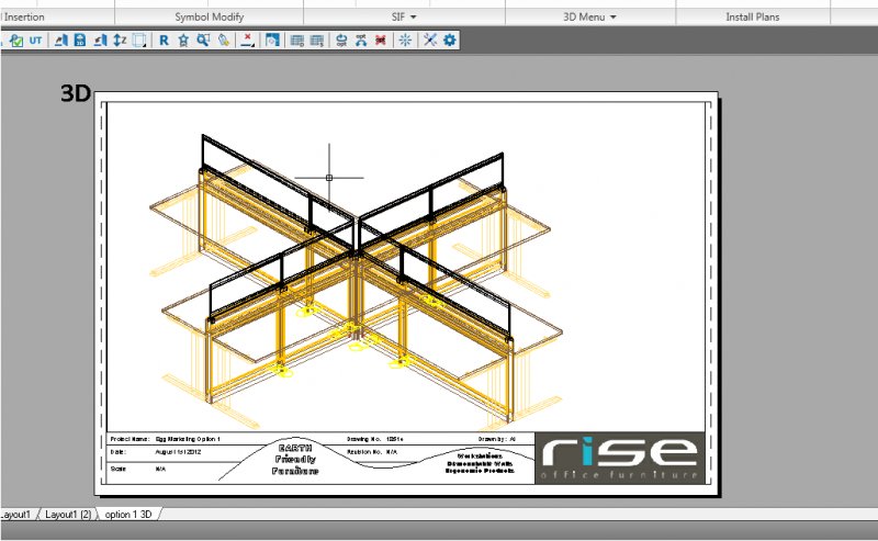

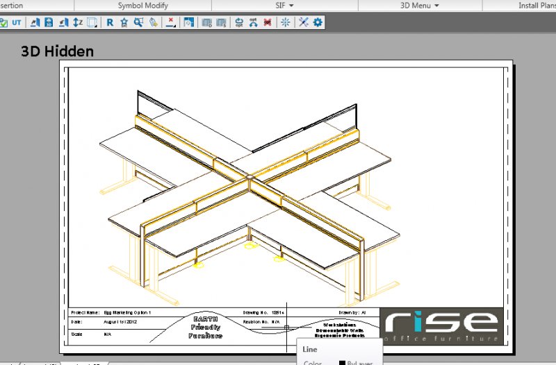

aiannetta Posted August 2, 2012 Share Posted August 2, 2012 hey! i have attached 2 photos as i have no idea how to properly explain this! picture 3D is how it should look, but once i hide it to get solid lines 3d hidden happens and the pieces disapear. i have tried to bring the objects to the front and it does not work. i have had this problem more than once and can usually get away with it by moving the objects that are hiding a little bit any way and usually they will show but its not working this time and i would like to know how to properly fix this for future issues! thank you! Quote Link to comment Share on other sites More sharing options...

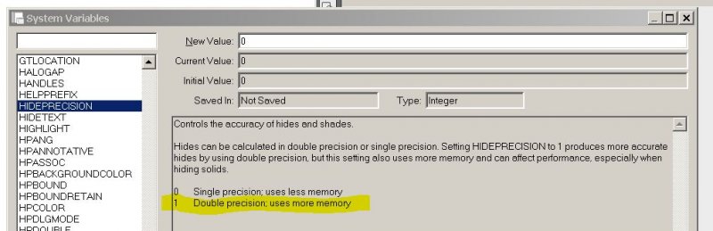

Dadgad Posted August 3, 2012 Share Posted August 3, 2012 This happens frequently with 3D Hide. Have you tried the regular HIDE command? Try it first, if it is still a problem then you can change your HIDEPRECISION system variable setting at the commandline, as shown in the image. Quote Link to comment Share on other sites More sharing options...
