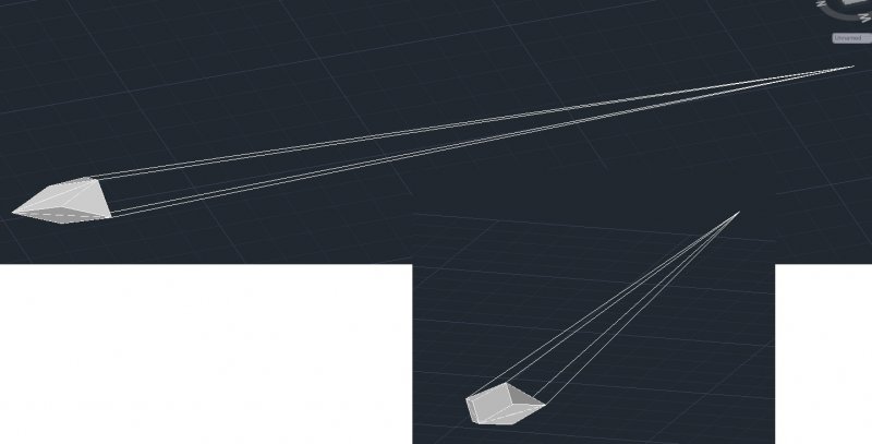

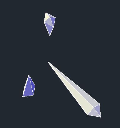

this is the beautiful shape that resulted from slicing...it looks like an F22 Raptor or Lamborghini Reventon
You shouldn't need to mess with the UCS to do the Extrude/Slice operation, simply Extrude the base and then slice the sides.
Also, you don't need to create a path for LOFT>POint, just change the Continuity to G0
[ATTACH=CONFIG]36292[/ATTACH]
Absolutely right nestly. The 3 Point option is a good slicing tool, unencumbered by issues of UCS, and totally appropriate in this case. :beer:
It can also be done with the LOFT to point option, without sacrificing the original intent, by playing with the loft properties after it is made into a solid.
[ATTACH=CONFIG]36293[/ATTACH]
YES! I did not know that; thank you again.This is much more convenient.
I did not manage to slice the sides...
