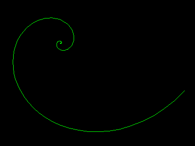

Logarithmic Spiral
(defun c:LogSpiral ( / a0 i v p a b l )
 (setq a0 0.0  ;; Start Angle
       i  0.1  ;; Increment
       v  500  ;; Vertices
 (princ "\nLogarithmic Spiral: r=ae^(b0)")
 (if
   (and
     (setq a (getreal "\nParameter a="))
     (setq b (getreal "\nParameter b="))
     (setq p (getpoint "\nBase Point: "))
   (entmakex
     (append
       (list
         (cons 0 "LWPOLYLINE")
         (cons 100 "AcDbEntity")
         (cons 100 "AcDbPolyline")
         (cons 90 v)
       (repeat v
         (setq l (cons (cons 10 (polar p (setq a0 (+ a0 i)) (* a (exp (* b a0))))) l))

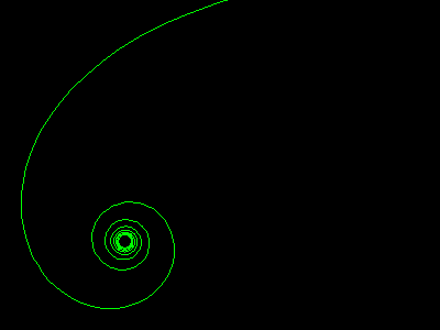

Hyperbolic Spiral
(defun c:HypSpiral ( / a0 i v a p l )
       i  0.1  ;; Increment
       v  500  ;; Vertices
 (princ "\nHyperbolic Spiral: r=a/x")
 (if
   (and
   (entmakex
     (append
       (list
         (cons 90 v)
       (repeat v
         (setq l (cons (cons 10 (polar p (setq a0 (+ a0 i)) (/ a a0))) l))

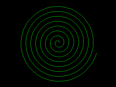

Archimedian Spiral
(defun c:ArchSpiral ( / a0 i v p a b l )
       i  0.1  ;; Increment
       v  500  ;; Vertices
 (princ "\nArchimedian Spiral: r=a+bx")
 (if
   (and
   (entmakex
     (append
       (list
         (cons 90 v)
       (repeat v
         (setq l (cons (cons 10 (polar p (setq a0 (+ a0 i)) (+ a (* b a0)))) l))

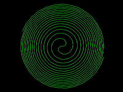

Fermat Spiral
(defun c:FermatSpiral ( / a0 i v p l )
       i  0.1  ;; Increment
       v  250  ;; Vertices
 (princ "\nFermat Spiral: r=+-0^0.5")
 (if (setq p (getpoint "\nBase Point: "))
   (entmakex
     (append
       (list
         (cons 90 (* 2 v))
       (repeat v
         (setq l
           (append
             (list (cons 10 (polar p (setq a0 (+ a0 i)) (- (sqrt a0)))))
             l
             (list (cons 10 (polar p (setq a0 (+ a0 i)) (sqrt a0))))

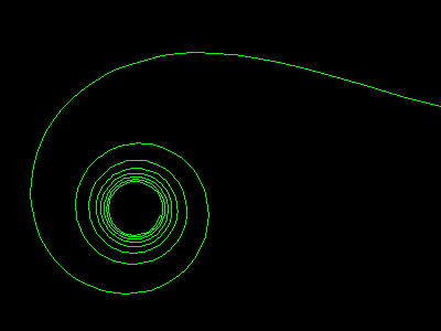

Lituus Spiral
(defun c:LituusSpiral ( / a0 i v p l )
       i  0.1  ;; Increment
       v  500  ;; Vertices
 (princ "\nLituus Spiral: r=0^-0.5")
   (entmakex
     (append
       (list
         (cons 90 v)
       (repeat v
         (setq l (cons (cons 10 (polar p (setq a0 (+ a0 i)) (/ 1. (sqrt a0)))) l))

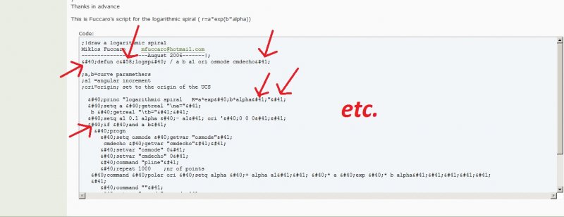

Quick question that is off topic but is illustrated in this post:
What causes code symbols like parenthesis to lose its symbol and show its alpha-numeric code?
I've run into this previously and don't want to decipher it.
Any suggestions on how to fix this and avoid it?
Thanks Greg :)
I believe the html character substitution occurs when an old thread is archived, or perhaps it happened when a server was changed - that'd be a question for David. A quick find and replace will fix it :)
Thanks for clarifying that Lee.
Makes sense.
I will look for a reference online that shows what html character equals what.
~Greg
The numbers in the html character expressions are just the ASCII codes, hence:
Since (chr 40) = (
There are many ASCII references, I use this one mostly.
For a HTML Special Character and ASCII reference, see the W3 Web Standards site here, and here.
