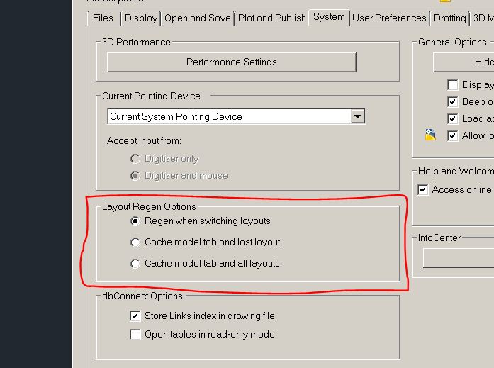

@denimoth it lags when I scroll in and out, but locks up when change from model to layout and layout to model space. Also takes a while for to reconize my commands.
Are you REGENERATING WHEN SWITCHING LAYOUTS, as shown in OPTIONS in the image?
