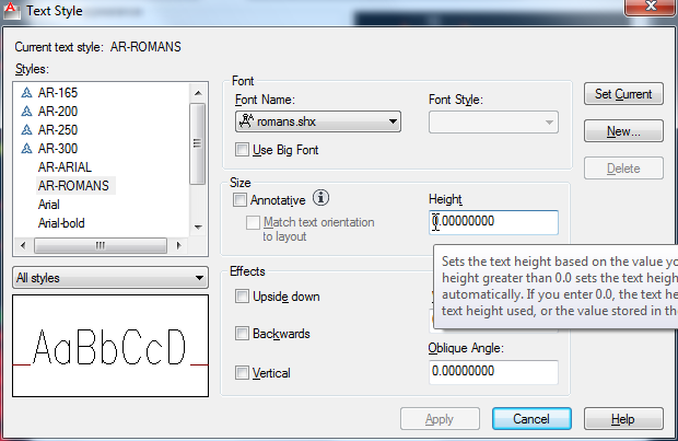

irneb Posted July 25, 2012 Posted July 25, 2012 Yep, something you absolutely HAVE to make certain of in your DimStyle: Every setting needs to be set as if your dimensions will be drawn for 1:1 scale. Only your OverAll scale might differ, though even this I'd advise against (either let to "Scale to Viewport Scale, or have it set as Annotative). This includes the text style you use, though here's another extra point: The text style itself needs to be non-annotative (even if your dimstyle is annotative) and have a default height= 0.0. The last is VERY important, otherwise the Dim cannot scale its text to the height it wants to display. Quote

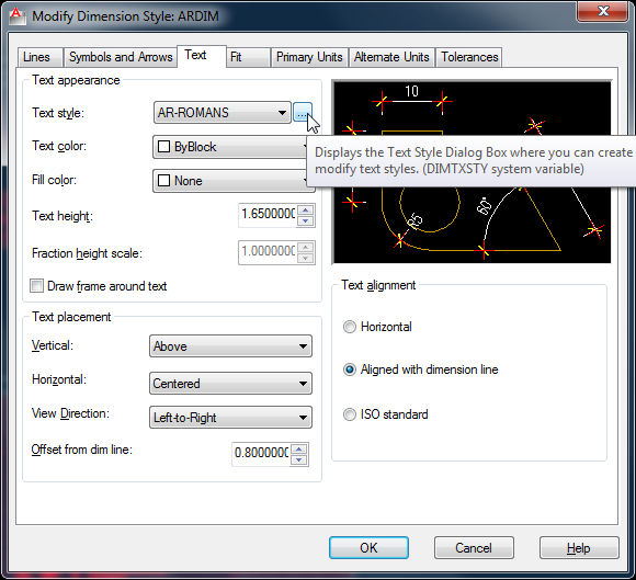

irneb Posted July 25, 2012 Posted July 25, 2012 No, you're misunderstanding. You need to set the Text Style's default height=0, not the DimStyle's text height. E.g. on the DimStyle dialog's text tab, click the [...] button next to the text style. That should open the Text Style dialog. In this the Height needs to be = 0. Then you might have to change the DimStyle's text to and from a different font, just to have the dialog update properly. Then the height should be editable in there. Quote
bgood2go Posted July 25, 2012 Author Posted July 25, 2012 ahh...that makes a difference.....working in wrong place...let me give it a whirl..thnx Quote
