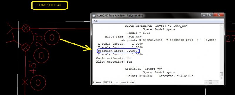

I drafted some point features with 0 degrees angle in one computer.

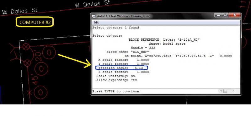

When i check in another computer in same drawing for that features those are showing with 5.579 degrees angle.
I expected that some system variable maybe change in that computer.Some one please tell me which variable i need to change? If this is not related to system variable please suggest me how to change this angle.

It sounds like a UCS issue, eh?
Are they both using the same NORTHDIRECTION setting?
Does this happen with any drawing?
Or just this one?
Hi All thanks for your response.
This is happening only for one computer. when i check with other computers all are showing correctly showing. in this computer all drawings are showing incorrect angle.
For your clear reference please find attached screenshots.
Mentioned already but the UCS is rotated in computer 2. So in computer 2 in that drawing use UCS, W, then PLAN, C. List the block again. Before changing any of this use the -view command, Save, give it a name. Later you or someone else can restore the view back to the way you found it.
