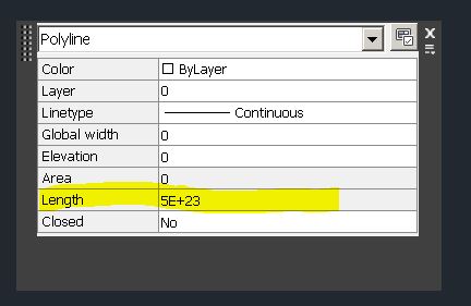

eldon Posted July 23, 2012 Share Posted July 23, 2012 A unitless model's drawing units will be millimeters (I believe). The units could be Light Years. There is no compunction to be millimetres 1 Quote Link to comment Share on other sites More sharing options...
Dadgad Posted July 23, 2012 Share Posted July 23, 2012 The units could be Light Years. There is no compunction to be millimetres In my case they are millimeters, but I always use ISO templates. How would you go about determining that then? When I use the -DWGUNITS command these are the only options that i get Command: -DWGUNITS Drawing units: 1. Inches 2. Feet 3. Millimeters 4. Centimeters 5. Decimeters 6. Meters ......no mention of anything terribly out of the ordinary, or should I say Cosmic? Quote Link to comment Share on other sites More sharing options...
eldon Posted July 23, 2012 Share Posted July 23, 2012 In my case they are millimeters, but I always use ISO templates.How would you go about determining that then? I would examine what was drawn to see if any units made sense. Also a good start is to see what the MEASUREMENT system variable is set to. Just because you use ISO templates, there is a large world out there who do not. Quote Link to comment Share on other sites More sharing options...

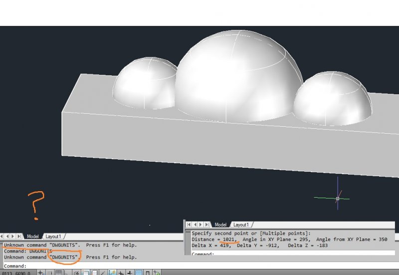

User2012 Posted July 24, 2012 Author Share Posted July 24, 2012 Thanks a lot for your comments! Frankly, I don't understand why the CAD drafter of this model, who has been working for an American company for years, didn't set units to the Inche! Anyway, because this model is the part of a patent design, I have not been allowed to share:oops:! I just drew sth simple in the environment of the model to show you how the measurements look like (Probably mm)! Meanwhile, I have tried DWGUNITS command, but it was an Unknown Command in my autocad program(See dwg file)! Sorry for being thick! UNITLESS_ TEST.dwg Quote Link to comment Share on other sites More sharing options...
rickh Posted July 25, 2012 Share Posted July 25, 2012 user2012, redo the command but include the dash (-) before it...."-dwgunits" Quote Link to comment Share on other sites More sharing options...

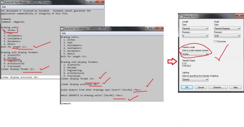

User2012 Posted July 25, 2012 Author Share Posted July 25, 2012 Now the command is working! Thanks! Meanwhile, I have checked Format> Units: it sounds like the unit has been changed to Inches! But, again the measurements of either the 3D model or any new drawing are not in Inches (see dwg file attached)! UNITLESS_ TEST.dwg Quote Link to comment Share on other sites More sharing options...

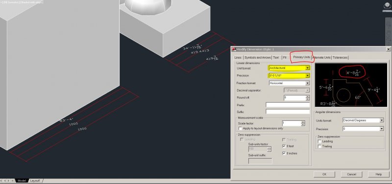

Dadgad Posted July 25, 2012 Share Posted July 25, 2012 The drawing units of the drawing you have attached already are INCHES. If you want them to display in inches or feet and inches you can go to your DIMSTYLE MANAGER select MODIFY as shown in the image and adjust the highlighted settings. I modeled the cube shown as 1000 units to a side, and you can see the measurement in feet and inches is correct. Quote Link to comment Share on other sites More sharing options...

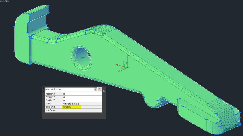

Dadgad Posted July 25, 2012 Share Posted July 25, 2012 (edited) What in the world is an unitless model? I never heard of such an object, please post an example. Since you asked SO nicely, here you go. Drawing database is mms, but the block is unitless. Unitless 3D Block.dwg Edited July 25, 2012 by Dadgad Quote Link to comment Share on other sites More sharing options...

Dadgad Posted July 25, 2012 Share Posted July 25, 2012 (edited) I am aware that the drawing data units are millimeters, but those come from the template, not from the model. When I created and saved the block it was on a metric template, but I saved the block as unitless. This is basically the point which I was addressing with eldon yesterday in post #6. I love a good puzzle, and am a big fan of deductive reasoning and entertainments, but it seems to me that in software like this, arriving at a definitive answer shouldn't rely too heavily on deductive reasoning, as it has proven to be rather elusive, even flighty or fickle at times. Just remember, we've all said and or heard it a million times on the forum, and it is true. DRAW EVERYTHING IN MODELSPACE FULL SIZED ......as crazy as that sounds. The very long polyline I just drew doesn't even show up on my screen if I zoom extents, but it is there! I would probably have to give it a width of a million miles before it would show up on the screen zoomed to extents. Just don't expect there to still be a lot of dimensional options available once you start using insertion units of lightyears. You can kiss architectural dims goodby! Edited July 25, 2012 by Dadgad Quote Link to comment Share on other sites More sharing options...
rickh Posted July 25, 2012 Share Posted July 25, 2012 saved the block as unitless OK, I see now regarding the unitless block. Thanks. That's new to me, even though the option is right in front of my face when making the block...guess I've never thought to change it. Quote Link to comment Share on other sites More sharing options...
SLW210 Posted July 25, 2012 Share Posted July 25, 2012 Unitless is a scale factor, not an indication of the UNIT of measurement in the drawing or used to design the object. Your BLOCK still has UNITS, where is your UNITLESS MODEL? Insertion Scale Controls the unit of measurement for blocks and drawings that are inserted into the current drawing. A block or a drawing that is created with units that are different from the units specified with this option is scaled when inserted. The insertion scale is the ratio of the units used in the source block or drawing and the units used in the target drawing. Select Unitless to insert the block without scaling it to match the specified units. Insertion scale has little to do with the units of measure you are using in the drawing, it is what it states INSERTION SCALE. In the units Dialog box, set LENGTH to your desired UNITS OF MEASURE. [ATTACH=CONFIG]36141[/ATTACH] As previously stated, if these units show the wrong measurement, then you need to scale the model. Why are you using an Educational version to work on Patent designs? Quote Link to comment Share on other sites More sharing options...
User2012 Posted July 25, 2012 Author Share Posted July 25, 2012 Unitless is a scale factor, not an indication of the UNIT of measurement in the drawing or used to design the object. Your BLOCK still has UNITS, where is your UNITLESS MODEL? Insertion scale has little to do with the units of measure you are using in the drawing, it is what it states INSERTION SCALE. In the units Dialog box, set LENGTH to your desired UNITS OF MEASURE. [ATTACH=CONFIG]36141[/ATTACH] As previously stated, if these units show the wrong measurement, then you need to scale the model. Why are you using an Educational version to work on Patent designs? Just trying to give a hand to a friend of mine! Now everything is working well! Thanx again! Quote Link to comment Share on other sites More sharing options...
