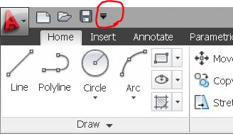

Dadgad Posted July 25, 2012 Posted July 25, 2012 Do you have the drop down menu arrow. like I have circled in the image? If so use it to select SHOW MENU BAR, where you can find your TOOLBARS. Quote

fostertom Posted July 25, 2012 Author Posted July 25, 2012 Ah man, that simple - the little drop down menu arrow - now I have File Edit etc. Thank you! I had not appreciated that File Edit etc can co-exist with Home Insert etc and ribbon - I thought it was either or. I can live with that - can find everything the old way plus play with the new. Too much. So now it looks like Classic uses the traditional toolbars as well as the ribbon - which I can minimise or close. I have saved as tom's classic. Thanks again Quote
