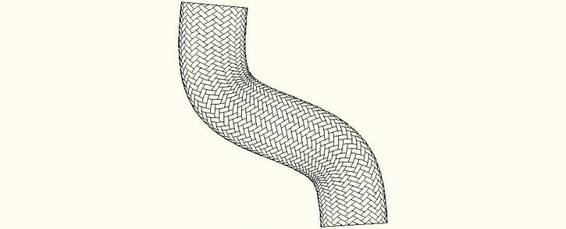

I figured one more thing - if 3dsolid is too small it may hang as also if unfolded face isn't exactly rectangle... So here is mine version of hatch by curved path explained process with small half ellipse extruded along spline path but shape positioned perpendicular to path (used vlax-curve-getfirstderiv spline endparam)... And when finished with UVmapping flattened splines with this code :

Nice one! how did you you do it?
the UV Mapping is not working for me...am using autocad 2010
thanks a lot for sharing
It is only working on A2009 32 bit... You have A2010, this is why...
And unfolded curved surface of 3dsolid may not be exact rectangle but canvas always is... Tried once more and it did projection even when shapes aren't perpendicular to path... What is even more interesting is to see Seant's example - Hatch.dwg (2010 file format - working probably on his comp., but haven't shared dlls, and splines aren't so deformed near boundaries as it's with mine example - don't know how if he used the same dlls as he posted)...
M.R.
Code changed in post #21...
To fully flatten splines, you also have to influence on fit points with elevation to 0.0...

  SEANT said:
Autodesk made some slight adjustments to the .NET API between AutoCAD 2009 and 2010. That adjustment, unfortunately, broke those two routines.
I’m updating everything but can’t say for certain that it will work for 2010 specifically – as I do not have that version to test against. The update targets versions 2012 – 2013.
If everything is finalized, upload your Path geometry. I’ll see what I can do. The routine update is still a “work in progress” but I can get it to work temporarily.
thanks for the reply Seant...
i am trying to immitate what M.R. has done :) until now no success hehe!
What I finally did is this :
- check in bios if your CPU has feature virtualization and enable it...
Download Windows6.1-KB958559-x64-RefreshPkg.msu - this is Virtual PC for Windows 7
Download WindowsXPMode_en-us.exe - this is emulator of XP Service pack 3 for Virtual PC for Windows 7
Install WindowsXPMode_en-us.exe
Install Windows6.1-KB958559-x64-RefreshPkg.msu
Then go to Start->Programs->Virtual PC->WindowsXPMode - start it => new virtual PC XP Desktop will initialize and wait to complete installation...
Download Autodesk AutoCAD 2009 32 bit with 32 bit keygen
Unzip archive with AutoCAD and go to Virtual PC XP mode; start windows explorer and copy unzipped folder from Windows 7 drive to XP drive (desktop if you want)...
Install AutoCAD 2009 32 bit on XP (use install readme and activate product with keygen)
Now you can use Sean's 2 dll files with netload...
BTW... If you plan to make elevation views from your model made from 3D solid geometry, you can use SOLPROF command to make elevations, place UCS to be parallel with made elevation geometry that will lie in one plane and use this modified routine to transform Seant's hatch splines from 3dsolids to plane :

Now you have elevation (get rid of 3dsolids and save in new DWG) witch can now be dimensioned and further used - it is all in the same scale as orig. model...
BTW, BTW. After you use dlls, I suggest that you use PURGE command to get rid of block used in projecting hatched canvas to 3dsolid face you picked... I think if you forget to purge it, your DWG may be corrupted when saving DWG - this is what happened when I firstly posted my example and after I had to replace it with correct one...
So long from me, M.R.
