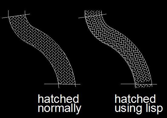

nod684 Posted July 19, 2012 Posted July 19, 2012 (edited) Hello, i am currently doing a landscaping job and i come across this problem in which the pavers (hatch pattern) should follow the curved path. Is there a way to to this in lisp? I have tried using a custom linetype (with shape) but it didn't worked. I also tried the expresstools superhatch but still no avail. as i was going through the threads here i still cannot find one. But i noticed LeeMac is very good in LISP. any other solution? any help would be very much appreciated Hatch.dwgFetching info... Edited July 19, 2012 by nod684 typo error Quote
MSasu Posted July 19, 2012 Posted July 19, 2012 My opinion is that is possible to write such routine, but it will be an extremely complicated task. The routine will have to follow the median path and draw perpendicular on it each row of tiles – the size of tiles on each row need to be slightly adjusted (increased or decreased) from one end of the row to the other to allow the consecutive rows to fit together. Also take care to don't exceed the lateral limits. And all this for just esthetical purpose. The said tile said size adjustment is similar with what the fitter workers will do in real life with the gap between rows. Quote

SEANT Posted July 20, 2012 Posted July 20, 2012 I’ve posted a mapping routine(.NET) that can simulate this functionality in this thread: http://www.cadtutor.net/forum/showthread.php?41260-drawing-on-a-sphere As a matter of fact, post #11 of that thread shows an example that uses the AR-HBONE. The workflow is a bit convoluted but here is an example of the result. Each brick shows some curve/morphing, so it may not be appropriate. Perhaps not too bad if it is just for a visual. Hatch.dwgFetching info... Quote

marko_ribar Posted August 7, 2012 Posted August 7, 2012 (edited) I think I figured out how to do it... Make solid with shape - half ellipse region positioned perpendicular to plline that is pedit=>splined as extrude path... NETLOAD => CPM => hatch => explode => CVP and that's it... Example I posted now is with half circle region shape and pline splined as extrude path with low number of vertices for curvature... But this explains whole process... It should project hatch on curved surface with CVP very fast... If it's slow something with surface is wrong - when unfolded result should always be rectangle... M.R. hatch-proj on curved surface.dwgFetching info... Edited August 7, 2012 by marko_ribar attached dwg was corrupted, so it's replaced with good one Quote
nod684 Posted August 7, 2012 Author Posted August 7, 2012 marko_ribar said: I think I figured out how to do it... Make solid with shape - half ellipse region positioned perpendicular to plline that is pedit=>splined as extrude path... NETLOAD => CPM => hatch => explode => CVP and that's it... Example I posted now is with half circle region shape and pline splined as extrude path with low number of vertices for curvature... But this explains whole process... It should project hatch on curved surface with CVP very fast... If it's slow something with surface is wrong - when unfolded result should always be rectangle... M.R. yes...and it is limited to this hatch pattern only. guess there is no way we can have hatch follow a path :sigh: Quote
eldon Posted August 7, 2012 Posted August 7, 2012 You can get an approximate picture with creating several blocks and using Measure. But in the real world, paviors are of fixed dimensions and are solid, so if the client sees the paviors following a curved path, and wants what he sees, you are going to have terrible problems making customised paving blocks. Better the client does not see some clever drafting, and you realise that your vision is going to cost an awful lot to achieve. However, if you have an unlimited budget, then go for it. Quote
