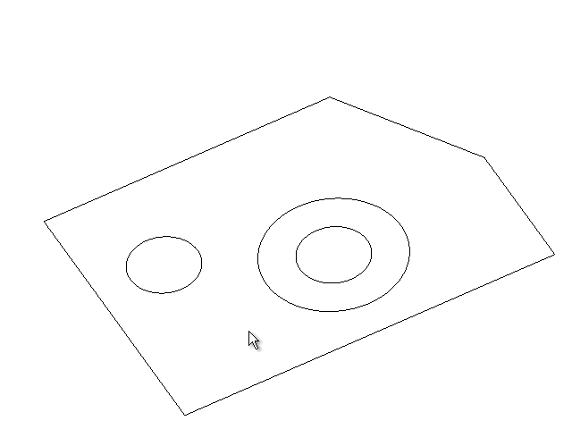

souptech Posted July 16, 2012 Share Posted July 16, 2012 Help! I have a simple 2D drawing that I have to convert to 3D and the drawing states that: Thickness: 0.5 & Boss Height: 0.25. I dont know if the height of the circles dia. 1.0 and 2.0 are set at 0.25 or is this added onto the thickness 0.5. Thank you in advance for any help. Quote Link to comment Share on other sites More sharing options...
nestly Posted July 17, 2012 Share Posted July 17, 2012 A "boss" is a raised portion (usually circular), so I believe the part is .5 thick with an additional .25 for the boss. Quote Link to comment Share on other sites More sharing options...
Dadgad Posted July 17, 2012 Share Posted July 17, 2012 That is how I would read that too. nestly, watching your videos makes ME want to learn autocad too, then I remember that I already know it, after the credits are run as I am filing out of the theater. Quote Link to comment Share on other sites More sharing options...

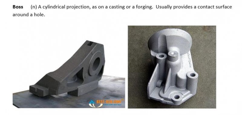

ReMark Posted February 4, 2015 Share Posted February 4, 2015 This explains what a boss is. Quote Link to comment Share on other sites More sharing options...
