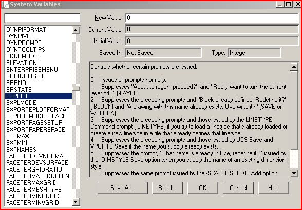

Using 2002, don't know if this suggestion will apply to your software, but it might, so
It is a good idea to enter SYSVDLG at the commandline and hit ENTER
that will take users on newer versions at least, to you SYSTEM VARIABLES DIALOG
where you can access any and all of the current system variable settings, as well as study other available optional settings.
As shown in the image, if you click the SAVE ALL button, your current system variable settings will be saved as an
.SVF (system variable file). Should you need to restore your settings to these values, after a coworker has rocked
your boat while you were laying on a beach somewhere tropical, or on coffee break, or if a poorly writtenlisp has lead you down
the garbage path to oblivion, just return to this SYSVDLG page and select READ at the bottom of the dialog box to access your
.svf and restore YOUR settings, in case there might be multiple users on your work station, be sure to give it an appropriate name
in case somebody else wants to save a different set, so yours don't get overwritten. :beer:
I think that most folks already understand that they should also set up a personal PROFILE in OPTIONS to make their lives easier. :)
