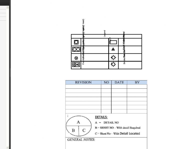

Everything was fine, but when I went to plot it (by converting it from .dwg to .pdf), the pdf showed the text plotting vertically (down to up) instead of horizontally (left to right). I've checked the properties of the text, nothing is glaringly wrong, and since it only appears after being plotted to .pdf, I'm not really sure what the problem is.

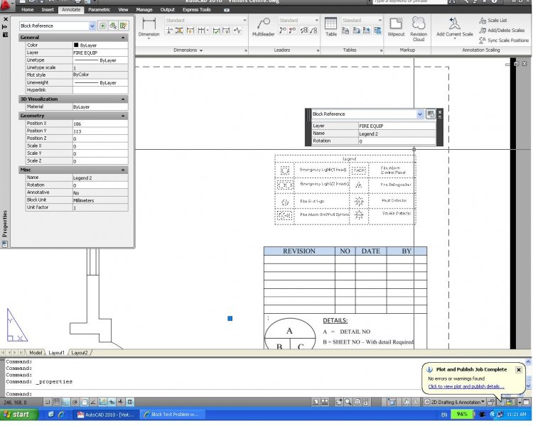

Here are some screenshots of the problem.
I would investigate your text style and see what all is checked.
Use the built in dwg to pdf.pc3. I see the same thing when text is set to Match Orientation in the style and the UCS is rotated in MS, but only with CutePDF and Bluebeam. With the built in Dwg to PDF it doesn't happen.
Or uncheck Match Orientation, or rotate the UCS in each VP to World.
Unchecking Match Orientation fixed the problem. Thank you!
