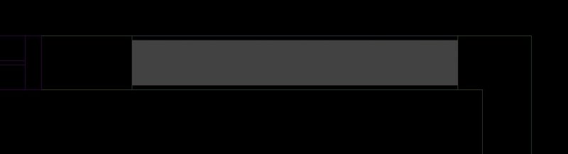

I can see how this would work, just can't write the code. Was wondering if someone could help. Basically, you would pick 3 points. The first 2 would determine the width and the 3rd would determine the length. Then, it would create a polygon using the width and length. I know it sounds weird, but it would really help.
Thanks

Something like this?

Kinda. That draws a rectangle. What I need it a polyline.

Upload a drawing shows your needs in it .

A rectangle is nothing more than a polyline entity.
So you are looking in fact for a single segment polyline with width different than 0?
Correct. The width would be determined by the first 2 points that are selected.
I know the image looks a little different than what I am explaning, but honestly all I need is the base code that creates it. I can tweak it to do what I want it to end up looking like.

That's an interesting way to go about it. It seems that the 2 points define the length, then it has a rubberband effect that does the width. If there was a way to type in a width or pick 2 points for the width, it would be great.

Yeah, that works great. Thanks!!!
