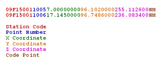

teknomatika Posted July 11, 2012 Share Posted July 11, 2012 Greetings. Is it possible, with a routine autolisp, read a txt file and enter each line type a comma separator in line position to be determined by routine? Specifically, I have a file of coordinates but no tab for it and wanted to enter their tabs, showing the position of each. Example of what I have: 5001100926.946000096.8278000221.264000NL 5001101025.256000096.9432000220.437800NE 5001101122.944000097.0376000219.154600NE 5001101222.372000096.9222000218.697200NM Example of what I want: 50011009,26.9460000,96.8278000,221.264000,NL 50011010,25.2560000,96.9432000,220.437800,NE 50011011,22.9440000,97.0376000,219.154600,NE 50011012,22.3720000,96.9222000,218.697200,NM I appreciate the help Quote Link to comment Share on other sites More sharing options...

eldon Posted July 11, 2012 Share Posted July 11, 2012 The data looks like a simple space delineated file, with columns 1 to 8 as the identifier, columns 9 to 18 as coordinate 1, columns 19 to 28 as coord 2, columns 29 to 38 as coord 3, and columns 39 and 40 as another identifier. I am afraid that pBe introduced a red herring on the combinations of data, as the OP had clearly stated the required output in the original post. Personally, I would do that with Excel which can split up data according to the columns and then save as a CSV file. Quote Link to comment Share on other sites More sharing options...
teknomatika Posted July 11, 2012 Author Share Posted July 11, 2012 Pbe, MSasu: In fact, each line in the source has this setting type: 09F1500110036.2210000096.1930000267.875600ND The first five characters (09F15001) I can easily delete using an editor like notepad or notepad + + Then, using the routine autolisp, I wanted to add a comma separator defining the position previously. In the example: 1003,6.22100000,96.1930000,267.875600, ND This corresponds to the order: point number, X coordinate, Y coordinate; Z coordinate; code. I apologize if I did not yet understand. Quote Link to comment Share on other sites More sharing options...

pBe Posted July 11, 2012 Share Posted July 11, 2012 I am afraid that pBe introduced a red herring on the combinations of data, as the OP had clearly stated the required output in the original post. Well, not really Eldon Notice clearly there are no space in the example: 5001100926.946000096.8278000221.264000NL How could you determine that the first "," goes before 26.946 50011009,26.9460000,96.8278000,221.264000,NL Whats preventing you from putting the frist comma before 9? Yes , The OP did show an output, now we can say comma goes before 2, we can determine that now because the output is shown. but that will be assuming the Y coordinate is always 2 numbers before decimals. and that IMO is not good programming And yeah, i might have exag a bit to prove a point Quote Link to comment Share on other sites More sharing options...
MSasu Posted July 11, 2012 Share Posted July 11, 2012 If @eldon is correct, then try: (setq stringTemp "5001100926.946000096.8278000221.264000NL") (setq stringNew (strcat (substr stringTemp 1 "," (substr stringTemp 9 10) "," (substr stringTemp 19 10) "," (substr stringTemp 29 10) "," (substr stringTemp 39))) But again, this works only if the structure of data is constant! Quote Link to comment Share on other sites More sharing options...
pBe Posted July 11, 2012 Share Posted July 11, 2012 But again, this works only if the structure of data is constant! And THAT exactly is what i'm drving at. In fact, each line in the source has this setting type:09F1500110036.2210000096.1930000267.875600ND The first five characters (09F15001) I can easily delete using an editor like notepad or notepad + + Then, using the routine autolisp, I wanted to add a comma separator defining the position previously. In the example: 1003,6.22100000,96.1930000,267.875600, ND Take this for example. OUTPUT 1003,6.22100000,96.1930000,267.875600, ND Why not 100,36.221000009,6.193000026,7.875600, ND The point is ,HOW can you tell where the value starts and ends? 100926.946000096.8278000221.264000NL 10036.2210000096.1930000267.875600ND Quote Link to comment Share on other sites More sharing options...
teknomatika Posted July 11, 2012 Author Share Posted July 11, 2012 If this is the case, then is very easy to treat the data programmatically. But I still tend to agree with @pBe - what if the coordinates are smaller/bigger than 2 digits and/or have a smaller/bigger number of decimals? Mircea, I understand. In fact in some lines there may be a major / minor number of decimal places. Consider the following sequence, the first line, which verifies that the positioning point may move to the right, depending on the units of each coordinate (units, tens, hundreds). In these cases, the difference of characters is offset by the elimination of decimal places in the same coordinated. In these cases, besides the importance of being able to define the routine placement of the comma separator, I have to be careful in treating these lines eventually treating them separately. I do not see another way to fix the problem. 09F15004128012.1640000103.357600113.245600OD 09F1500412818.69700000100.978600142.721400RD 09F1500412824.80900000101.967000112.053400RD 09F1500412834.72000000101.520800112.992800RD 09F1500412843.94700000102.08440067.2318000RD 09F1500412851.67800000103.435000351.147600RD 09F1500412861.76000000103.541200226.526200RD 09F1500412878.81200000100.714400187.285600RD Quote Link to comment Share on other sites More sharing options...

teknomatika Posted July 11, 2012 Author Share Posted July 11, 2012 And THAT exactly is what i'm drving at. Take this for example. OUTPUT 1003,6.22100000,96.1930000,267.875600, ND Why not 100,36.221000009,6.193000026,7.875600, ND The point is ,HOW can you tell where the value starts and end? The structure of each line is this: See attached image: Quote Link to comment Share on other sites More sharing options...

MSasu Posted July 11, 2012 Share Posted July 11, 2012 If you are absolutely sure that the data lies on constant width columns, then try to adjust the example that I gave you. But, please, don't forget to double check each and every result after processed. Quote Link to comment Share on other sites More sharing options...
teknomatika Posted July 11, 2012 Author Share Posted July 11, 2012 If you are absolutely sure that the data lies on constant width columns, then try to adjust the example that I gave you. But, please, don't forget to double check each and every result after processed. Mircea, Yes, the sample result. Unfortunately I do not have sufficient knowledge to integrate this code in a routine to do line by line from the reading of a file. Hence my request for help. Quote Link to comment Share on other sites More sharing options...
