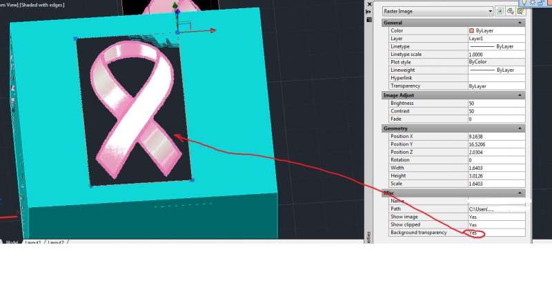

samchums26 Posted July 11, 2012 Posted July 11, 2012 insert the PNG file in autocad, click the image and right-click go to properties. Go to MISC, background transparency, and then select yes. Quote

User2012 Posted July 12, 2012 Author Posted July 12, 2012 Thanks! Now the transparency is working! I am just wondering why the white color of the background turned Black after applying the transparency in CAD! Meanwhile, I tried Decal Quote
