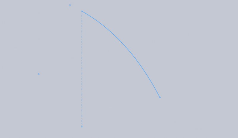

thronedflame Posted July 10, 2012 Posted July 10, 2012 Hi I want to use the revolve feature to revolve a parabola, creating a nose cone type object. However it won't let me. I figured a parabola line, with a center line would work, but it says the object is open. So I tried connecting all the lines but it says that a single center line should be used. Can someone help me out? Thanks Quote

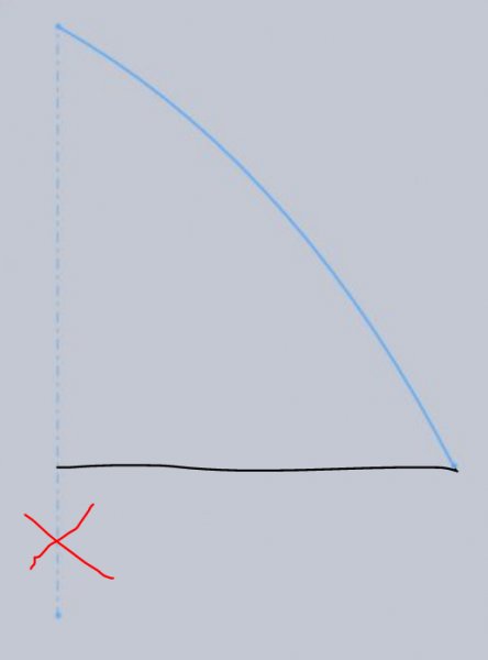

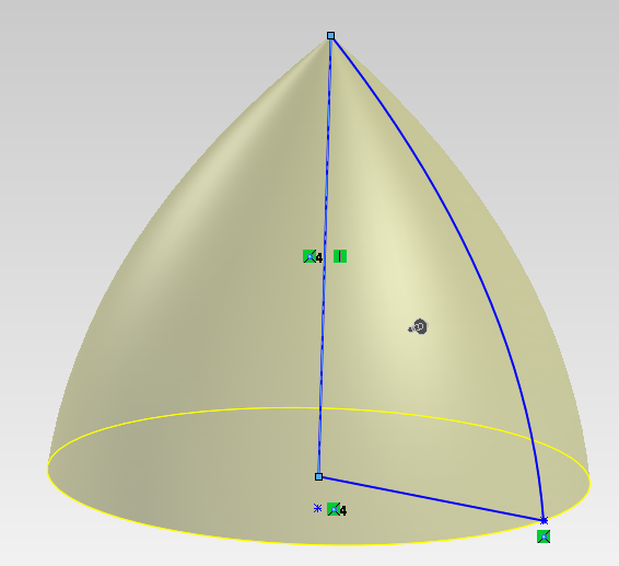

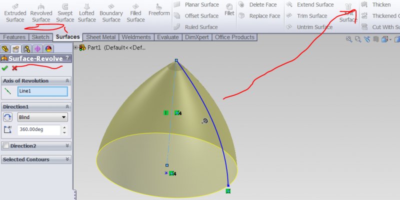

JD Mather Posted July 10, 2012 Posted July 10, 2012 Have you at least gone through the Help>Tutorials. Your profile is open - you could use the Surface Revolve and then Thicken or close off as shown and then Trim excess (Solidworks will still see as open profile because of center line is also construction linetype in SWx - but it will offer to close the profile for you and revolve. If you want a Thin feature then Shell the part after the Revolve. Quote
JD Mather Posted July 10, 2012 Posted July 10, 2012 So I tried connecting all the lines but it says that a single center line should be used. You didn't show this image. Did you use only one center line? Quote
SLW210 Posted July 10, 2012 Posted July 10, 2012 You need to close as indicated. [ATTACH=CONFIG]35867[/ATTACH] Quote
thronedflame Posted July 10, 2012 Author Posted July 10, 2012 I tried both approaches. Neither worked. I want it to be a thin feature. Is that problem? Quote

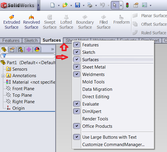

thronedflame Posted July 10, 2012 Author Posted July 10, 2012 I get rebuild error: sketches used for revolve features use a single, non-self intersecting contour, and either a single center line, or one that is currently selected. Also I dont have the surfaces tab. Quote
JD Mather Posted July 10, 2012 Posted July 10, 2012 Right click on your file name and select Send to Compressed (zipped) Folder and attach the resulting *.zip file here. On this particular revolution I could not do a Thin Feature in the revolve. I had to Revolve and then Shell or Surface Revolve and Thickne. Quote
JD Mather Posted July 10, 2012 Posted July 10, 2012 To get Surfaces tab right click on any other tab and select Surfaces or Insert>Surface>Revolve Quote
thronedflame Posted July 10, 2012 Author Posted July 10, 2012 Ok I got the surface to revolve, both ways actually. And I was able to make it a shell. But is there a way to get rid of the bottom surface so that it is open? Quote
thronedflame Posted July 10, 2012 Author Posted July 10, 2012 Aside from just making a extruded cut using a circle i mean Quote
JD Mather Posted July 10, 2012 Posted July 10, 2012 When you Shell you click on the faces you want to remove (in this case the bottom face). Quote
