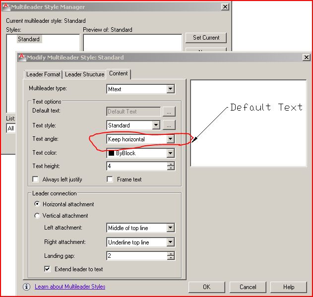

Dadgad Posted July 13, 2012 Posted July 13, 2012 rickh said: Is it possible the text you are trying to rotate is a civil 3d label and not mtext? Or a MULTILEADER style? Quote
bachrock Posted July 13, 2012 Author Posted July 13, 2012 Dadgad said: Or a MULTILEADER style? It should be mtext as that's what properties tells me and that's the command I remember using. Plus, I didn't know about mleaders when I was doing the addresses. Quote

SLW210 Posted July 13, 2012 Posted July 13, 2012 SLW210 said: You have selected "Match Text Orientation to Layout" in Text Style. For already created Mtext this will need to changed through properties. I have attached my file and your original. P.S. I deleted some AEC objects from yours and -PURGED everything file got LARGER. So I WBLOCKED the text to a new file and file size much smaller. I think may be some problems in your drawing. Do you use a third party app or recieve files from vertical programs? Quote
bachrock Posted July 13, 2012 Author Posted July 13, 2012 SLW210 said: For already created Mtext this will need to changed through properties. I have attached my file and your original. P.S. I deleted some AEC objects from yours and -PURGED everything file got LARGER. So I WBLOCKED the text to a new file and file size much smaller. I think may be some problems in your drawing. Do you use a third party app or recieve files from vertical programs? Ah, I just need to switch a YES to a NO. Thanks Hulk and everyone else for helping. Quote
