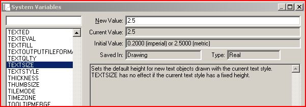

I trust you are aware that your text size is controlled by the TEXTSIZE system variable, or possibly by your TEXTSTYLE system variable
by default, as described in the image?

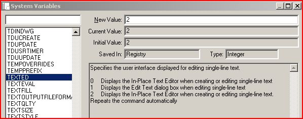

There is one more system variable which you might like to consider, although I think your immediate problem has been taken care of by rkent.
