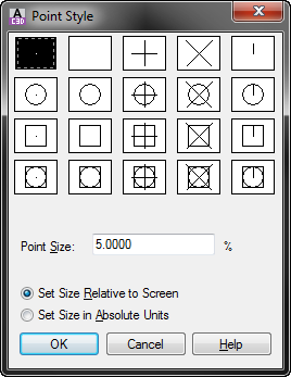

I would like to change the look of the point that I draw ni autocad.
When i draw a point (1 on the joined picture), I can choose different style (point, circle, square, ...) and increase or reduce the size (2 on the joined picture)
but the model stay allways thin, i would like to modify my point to look like the 3 ont the joined picture.
I know that 20 models are allready a lot of choice, but is there a possibility to modify the library of the point?
Thank in advance for your help

I assume you are talking about these choices.
As far as I know, you cannot modify these or add to the choices. Do you have to use a POINT entity? Have you considered using a block instead?
[ATTACH]35855[/ATTACH]
I knew that somebody will talk about block instead of point marker, but it will be impossible to replace thousand of point (dwg given by our client) by block.
It's weird that we can't edit the point marker library, no ?
Are the points on their own layer?
Are the points on their own layer? Yes or No?
There are several layers with their own type of points
Wonderful. Then you could place a block (on a separate layer) at each one of those points, using a lisp routine, then freeze the points layer.
.....but it will be impossible to replace thousand of point (dwg given by our client) by block.
Not really. Is see ReMark has already steered you in the right direction.
It's been hardcoded since...well, forever. I guess that is why other programs use blocks to display objects (i.e. manholes, survey points, etc.) differently, in an unlimited amount of ways.

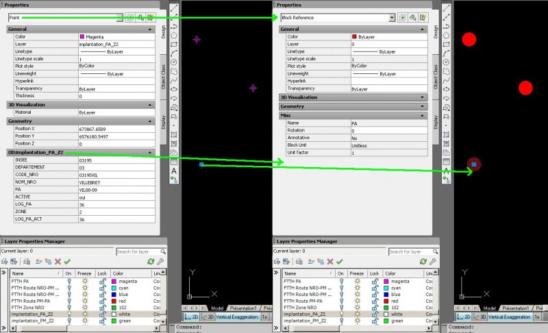

I worked onthis subject since this summer.
I have a routin which transform point to block (which is selected in the block allready present in the dwg)
BUT
My point contain Object Data. And when I use this routin, I obtain block whiwh don't recover Object Data.
On this joined picture :
left : before routin (point with object data)
right : after routin (block without object data)
Below the code of the routin i use.
Do you think there is a possibility to modify this routin to transfer the object data from point to block?
Thank you in advance.
