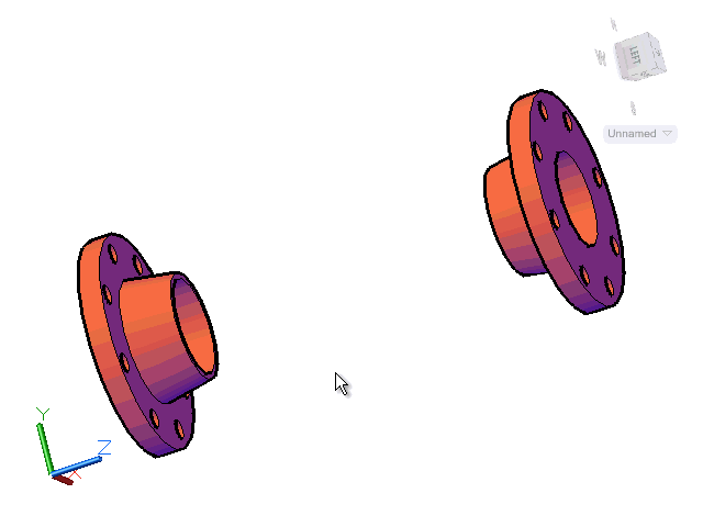

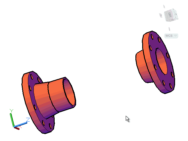

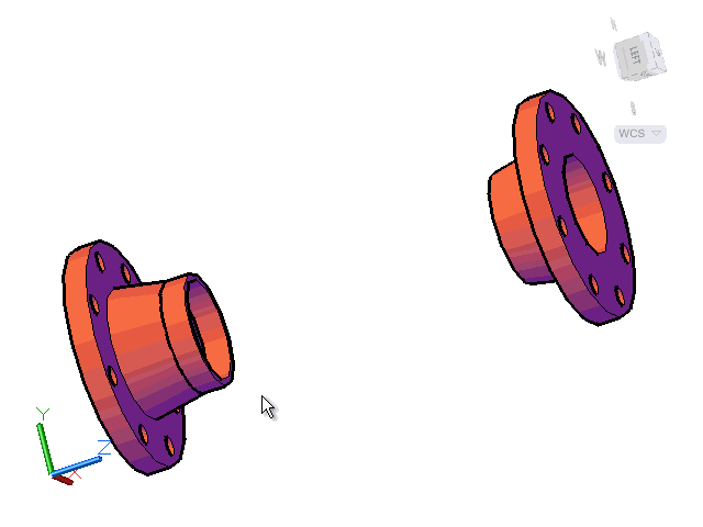

nestly Posted July 10, 2012 Posted July 10, 2012 AutoCAD doesn't really support 3D dynamic blocks. There are some things you can "fake", but you definitely can't "stretch" a 3D solid inside a dynamic block. Scaling wouldn't seem a very efficient method to me because you'd have to calculate the scale factor. I usually just Move>Faces or Extrude>Faces and the centerpoint OSnap to stretch 3D solid "pipes". or you can Ctrl+Click the face and stretch it with it's grip. Quote

nestly Posted July 10, 2012 Posted July 10, 2012 its more of a case of just dropping the block in and resizing to suit by using snaps as opposed to calulations etc. Just trying to make the actual drafting of a pipe run as efficiant and consistant as poss As I said previously, it's not possible to "stretch" 3D a solid object with a Dynamic Stretch property in regular AutoCAD. The closest you can get is to put an extruded section of "pipe" in a block, then insert it exploded, then grip edit it's length as shown in the 1st animation posted above. Quote
