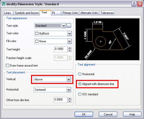

I prefer to have my dimesions formated with the text above the dimension line. This seems to work fine for horizontal dimensions but when I change the properties of a vertical dimension to be above and rotated 90° the dimension text remains in-line with the dimension line.
Can anyone offer some advice on this. It seems that when I choose the ISO Std Dim Style, I get the formats like I want but when I define my own this does not happen like I want it.
I'm not sure I understand what you're after. Can you post an image of what you want?
That's an easy one. Take a look at the screenshot below and change your settings to match the ones outlined in red.
