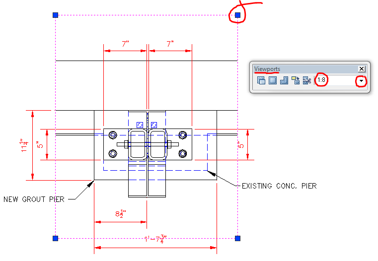

ReMark Posted August 13, 2012 Posted August 13, 2012 An example of a detail, drawn in model space, and displayed in a viewport. Look to the right and you'll see the Viewport toolbar. It lists the scale. There are a number of default scales one can choose from just by clicking on the down-pointing arrow. I strongly suggest the use of the Viewport toolbar for assigning a scale. Another option would be to use the Properties palette. The screenshot was taken from inside AutoCAD 2004. Quote

ReMark Posted August 13, 2012 Posted August 13, 2012 Three options exist for assigning a scale to a viewport in 2004. There are the two I mentioned previously and the one rkent just mentioned: Zoom > Scale nX or nXP. I think you'll find the two I mentioned easier. Quote
