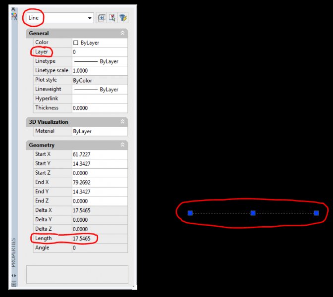

ReMark Posted July 5, 2012 Posted July 5, 2012 Gonna have to charge you extra. LoL LIST is a command. One can type it into the command line then when prompted select an object, like a line, then press Enter. A text window will pop up. Here is an example of what you might see it it. LINE Layer: "0" Space: Model space Handle = 1b5 from point, X=0'-1 1/4" Y=-0'-3 11/16" Z= 0'-0" to point, X=1'-3 1/4" Y=-0'-3 11/16" Z= 0'-0" Length = 1'-2", Angle in XY Plane = 0 Delta X = 1'-2", Delta Y = 0'-0", Delta Z = 0'-0" Quote
ReMark Posted July 5, 2012 Posted July 5, 2012 Are you using the drop-down menus at the top of your screen to access your commands or are you using Toolbars? Menu: Click on Tools > Palettes > then Properties. The Properties palette should appear on your screen. If you click on an object, like a line, then consult your Properties palette you'll be given a whole host of information. Quote
