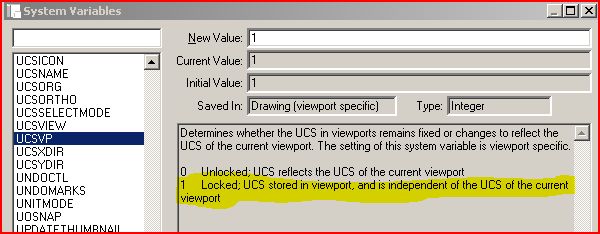

I am using 2007 so do not have the viewcube. All I want is for the UCS to move in all view when I move it. At present I have three separate UCS
I should say that the UCS all work as three separate positions. Hope this makes sense

I did not understand from your earlier posts that you were talking about modelspace viewports.
The UCS in all of these viewports is the same, in relation to the solid displayed therein.
It is WCS, and it is locked by your UCSVP system variable setting.
For me that is how I like it.
Check the description in the attachment of the UCSVP system variable setting options.
When looking down in TOP view you see PLAN view, showing your X & Y axii, as expected.
Looking from FRONT view you now see the Z & X axii displayed.
When looking at the ISO view you can see that the X & Y planes still represent the ground plane, and that the Z axis represents the height of your structure, as in both of the other views.
They are all displaying the exact same UCS from 3 different perspectives, but the UCS is locked and maintained in each viewport.

Thanks Dadgad, you're a diamond! Not too familiar with the system variables so that really helped
