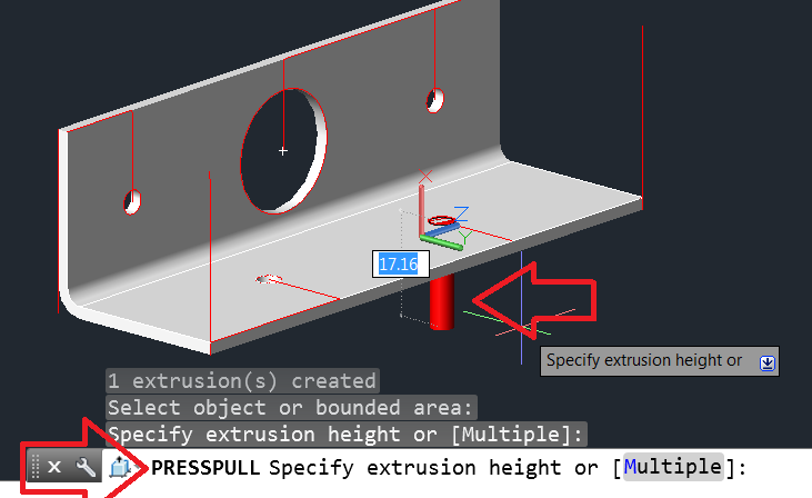

JD Mather Posted July 9, 2012 Posted July 9, 2012 stef_r said: I'm used to draw on grid lines with a specified distance between them. Like the others stated - I turn grid off. Turned it off in my second CAD class back in '87 of the last century. Laughed as the teacher kept using grid counting like a second grader. Use direct distance entry or offset and trim/extend to establish locations. I haven't counted dots since 2nd grade. Type presspull (one word just like that, there is a workspace with all of these commands on icons - you might be ready to investigate that workspace. Look for an icon that looks like a gear in the upper left or lower right corner of the screen. Click the down arrow and select 3D (only do this if you feel comfortable and as you do it you should also see the technique to get back to where you were - pay attention to all options). I missed a step - be sure to click on one of the corners of the viewcube or Shift turn middle mouse wheel to rotate your model where you can see all circles clearly. Now after typing presspull and hitting Enter move your mouse into one of the circles. Pause briefly and then click the mouse inside the circle as though circle and then move the mouse through the part like a drill bit. Go well past the part to make sure your drill bit goes all the way through and then click on the screen. Don't worry about typing in an exact distance for the drill - just go past the part to go all the way through. Repeat for each hole. Attach your part here and I (or someone) will then explain how to get the slots (you might be able to figure this out yourself now). Once we get all of the holes we get to the really fun part - creating the 2D drawing the easy way. Quote
Dadgad Posted July 9, 2012 Posted July 9, 2012 JD Mather said: Like the others stated - I turn grid off. Turned it off in my second CAD class back in '87 of the last century. Laughed as the teacher kept using grid counting like a second grader. Use direct distance entry or offset I haven't counted dots since 2nd grade.Attach your part here and I (or someone) will then explain how to get the slots (you might be able to figure this out yourself now). Once we get all of the holes we get to the really fun part - creating the 2D drawing the easy way. [ATTACH=CONFIG]35824[/ATTACH] Very well said JD! nestly's video shows how to make the slots, should you need your memory refreshed. Quote

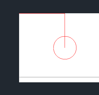

stef_r Posted July 9, 2012 Author Posted July 9, 2012 Dadgad said: Very well said JD! nestly's video shows how to make the slots, should you need your memory refreshed. Drawing_L_Bracket3.dwgFetching info... Here's my 'beatifull' 3D bracket with holes. I thank Nestly's for his awesome video, but unfortunally I still have some trouble with the [trim] command. That's why I still have a big round hole in middle instead of a wider slot. But that's something I will work on to get that fixed :-) (I select the TRIM command and then start selecting the lines as in the video. But after that I get stuck; think I have to put in some kind of command if I look to the statusbar below...) Anyway, this is not a very big issue; a hole is as good as a slot and maybe easier / cheaper to fabricate, but it sure would be nice knowing how to draw it. If I turn this in a 2D drawing, can I automatically put all the right meassurements with it, or do I still have to do that by hand, one by one? Quote
Dadgad Posted July 10, 2012 Posted July 10, 2012 (edited) That is nice to hear, sounds like you are starting to get the hang of it, and enjoying how it looks, cool! When you use the trim command, try entering TRIM then right click twice, then select the lines you hope to trim out. As I recall I think nestly selected a single cutting edge. In that way everything in the drawing is selected as a trimming edge, so wherever lines touch or cross you can easily trim either of them. Did you remember to use the FILLETEDGE command to relieve the sharp corners of the bracket with a nice radius of about 4? When you are totally satisfied with how your piece looks, we will let the program do the 2D drawings, after which you will do the dimensions by hand. Edited July 10, 2012 by Dadgad Quote
