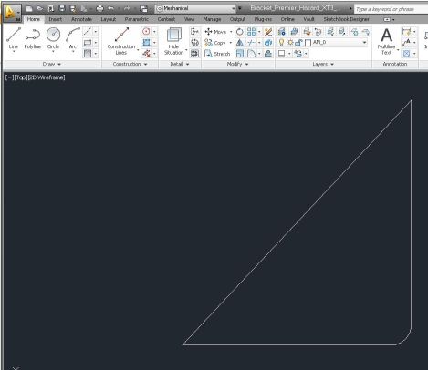

stef_r Posted July 6, 2012 Author Share Posted July 6, 2012 Hit PE on the keyboard and then Enter. Click one of the lines and hit Enter for Yes. Hit J on the keyboard and hit Enter for Join. Select the arc and other line. And here is were I get stuck... First of all, thank you for this great explanation! I have viewed some tutorials from this site so I did know how I could draw a simple line, circle or box. And how I could type in the dimensions etc. But again, thank you for explaining it to me. Everything goes well and does what you wrote down. But it goes wrong at the end, when I have selected the arc and the bottom line. It looks like the program needs an enter or other command to stop before I can proceed to the next step. Like you mentioned, if everything went right, the whole profile should be highlighted, but with me only a part is being highlighted. Just the part I click on. Oyeah, one other thing... I think if I follow your instructions, it is going to be a drawing in 3D right? Quote Link to comment Share on other sites More sharing options...
Dadgad Posted July 6, 2012 Share Posted July 6, 2012 (edited) And here is were I get stuck...First of all, thank you for this great explanation! I have viewed some tutorials from this site so I did know how I could draw a simple line, circle or box. And how I could type in the dimensions etc. But again, thank you for explaining it to me. Everything goes well and does what you wrote down. But it goes wrong at the end, when I have selected the arc and the bottom line. It looks like the program needs an enter or other command to stop before I can proceed to the next step. Like you mentioned, if everything went right, the whole profile should be highlighted, but with me only a part is being highlighted. Just the part I click on. Oyeah, one other thing... I think if I follow your instructions, it is going to be a drawing in 3D right? Yes, the instructions JD gave you will be MODELING in 3D the object which you are interested in representing. Be sure to select one of the lines first, not the arc, do it exactly as described in JD's post. Can you upload what you have so far? Edited July 6, 2012 by Dadgad Quote Link to comment Share on other sites More sharing options...

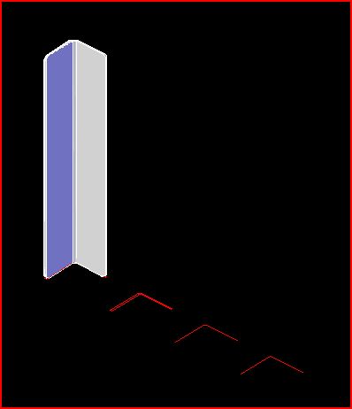

stef_r Posted July 6, 2012 Author Share Posted July 6, 2012 Ok, this is what I got so far. I have followed the steps until the commend. So far the commands spoke for themselves but what does the command do exactly? Quote Link to comment Share on other sites More sharing options...
Dadgad Posted July 6, 2012 Share Posted July 6, 2012 The EXTRUDE command will create a 3d solid entity from a closed polyline. It is a modeling command. It will also create SURFACES from POLYLINES. At this point you appear to have a closed polyline, which is not exactly what you are after. It would be easier to tell what is going on if you posted the .dwg file. At this point I would suggest (based on the ASSUMPTION that what I see is a closed POLYLINE) that you explode it, then reJOIN the horizontal line with the arc and the vertical line using the PE command, as discussed earlier, and in JD's post. Quote Link to comment Share on other sites More sharing options...
