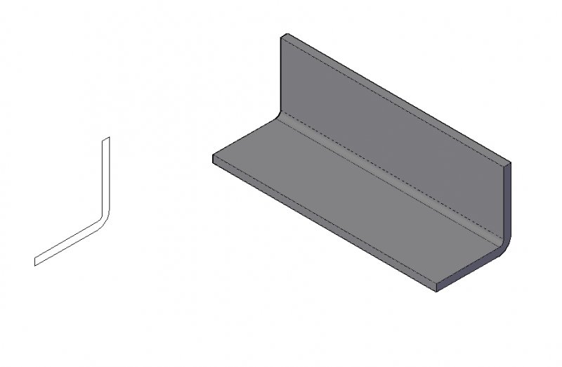

My version of your bracket. Since you provided no dimensions consider this a rough approximation.
[ATTACH=CONFIG]35741[/ATTACH]
Semantics. Draw it, model it, create it, construct it.
In my world "draw it" means 2D drawing. "Model it" means create 3D CAD model. Create or construct it means go out on the shop floor and, well, create it.
Does your version have a bend? Hard to tell from the picture? In any case, must have a bend to unfold.
No, I did not include a bend. It was strictly a hack job.
Is this what you were referring to?
Yes, that is what I was referring to, but it looks like the bend radii are incorrect (hard to tell from picture), it looks like the material is thicker at bend. (see end, or particularly at the punched hole) Could be optical illusion. I answer a lot of sheet metal questions where this is a common mistake - thus I must give you a hard time about it.... :P
Since the OP asked about how to draw lines at the start, I don't think the correct radii to get the piece made is the top of his worries...
I fully admit to the fact that what I did, as far as anyone with any real knowledge of sheetmetal fabrication goes, was entirely a hack job and should not be mistaken for the definitive method of modeling the bracket. The model was strictly for demonstration purposes only. No offense to those of you with the knowledge I lack and no offense taken on my part. I would like to learn more about sheetmetal fabrication techniques and the proper way of detailing such but I've got limited time and my current job does not require that particular set of skills. We all good?
Well as long as you're DRAWING something! :shock: :thumbsup:
Make it a cold one. :beer:

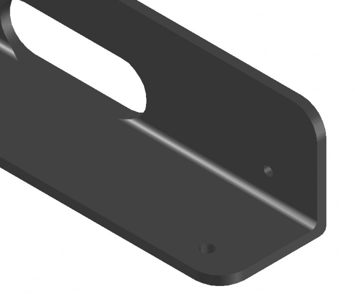

stef_r: A quick bracket created using a profile of the shape and the PRESSPULL command. Holes and slots can be punched through afterwards using the same command.
Profile does not look uniform thickness.
The outside radius should be = inside radius + thickness.
Well it's no rough draft. Perhaps it is the angle. I verified that the profile did indeed exhibit a uniform thickness (.09375). For the posted example the inside radius was .0625 and the outside radius was .15625. And yes, I know, the thickness is probably way too much for sheet metal but once again the purpose of the exercise was to demonstrate a method for modeling a simple bracket using a profile.
If I had know I was being graded today I would have brought a sharper pencil. LoL
I need to come up with a disclaimer. Objects shown are in no way representative of the real world. View at your own risk.:shock::lol:
