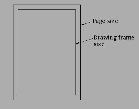

souvik Posted July 4, 2012 Posted July 4, 2012 I need a lisp which will draw a rectangle according to a given page size (Like ISO A4, A3, A1) in both landscape and portrait format. Please help me. Quote

eldon Posted July 5, 2012 Posted July 5, 2012 On a purely practical observation, those are actual sheet sizes and do not have the usual framing offset margin of 15mm. If you try to use those sizes for drawing frames, then you will never be able to plot the drawings with the frames showing to your required scaling. Quote
souvik Posted July 7, 2012 Author Posted July 7, 2012 On a purely practical observation, those are actual sheet sizes and do not have the usual framing offset margin of 15mm. If you try to use those sizes for drawing frames, then you will never be able to plot the drawings with the frames showing to your required scaling. Hi Eldon. Sorry for late reply. You are absolutely right. We have to deduct 20mm from the original paper size.. Quote
MSasu Posted July 8, 2012 Posted July 8, 2012 The above code can be adjusted to draw the inner rectangle too: ; Draw an ISO Format (08-VII-2012) (defun c:DISOF( / listSize size poz border ) (if (and (not (initget "A4 A3 A2 A1 A0")) (setq size (getkword "\nFormat [A4/A3/A2/A1/A0]: ")) (not (initget "Portrait Landscape")) (setq poz (getkword "\nPozition [Portrait/Landscape]: "))) (progn (setq listSize (nth (abs (- 4 (atoi (substr size 2)))) '((297.0 210.0) (420.0 297.0) (594.0 420.0) (841.0 594.0) (1189.0 841.0))) border 20.0) (if (= poz "Portrait") (setq listSize (reverse listSize))) ;;; outer rectangle (command "_RECTANGLE" "_non" '(0.0 0.0) "_non" listSize) ;;; inner rectangle (command "_RECTANGLE" "_non" (list border border) "_non" (list (- (car listSize) border) (- (cadr listSize) border))) (command "_ZOOM" "_E") ) ) (princ) ) Quote
