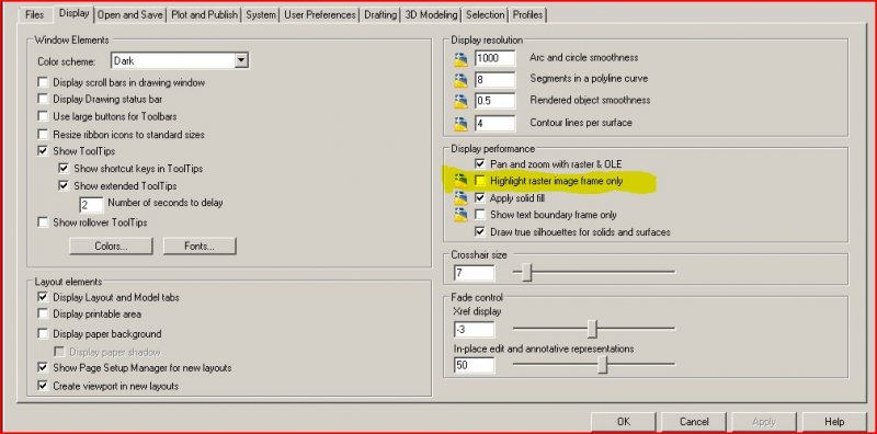

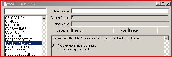

Dadgad Posted July 4, 2012 Posted July 4, 2012 There are two option as you said and when you chose 'Create from file' you can select any file you want, but nothing happens (apart a white rectangular with name as I mentioned before) when you try anything else beside BMP format. Blackfish, please check this setting (if it is available in LT) sounds like it might be the fly in the ointment here. Or could it be the RASTERPREVIEW setting? Quote
Blackfish Posted July 4, 2012 Posted July 4, 2012 Sorry Dadgad, but I'm just saying that AutoCAD LT doesn't support other image file than BMP when inserting as an object into drawing (INSERTOBJ). There is no problem with images attached into drawing as a reference (IMAGEATTACH command). However I couldn't find anything in documentation saying that LT is limited to bitmap images using INSERTOBJ. PS. In LT there is no such complex Option Dialog Box, but I've checked variables and all are properly set. Quote
Dadgad Posted July 4, 2012 Posted July 4, 2012 Sorry Dadgad, but I'm just saying that AutoCAD LT doesn't support other image file than BMP when inserting as an object into drawing (INSERTOBJ). There is no problem with images attached into drawing as a reference (IMAGEATTACH command). However I couldn't find anything in documentation saying that LT is limited to bitmap images using INSERTOBJ. PS. In LT there is no such complex Option Dialog Box, but I've checked variables and all are properly set. No apologies required Blackfish, I am just throwing some stuff out there trying to help, I don't know much about Raster. Rasta, I got you covered. Quote
