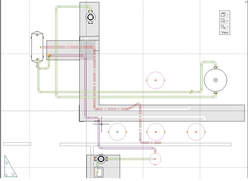

Cadallac Posted July 3, 2012 Author Share Posted July 3, 2012 Another quick noob question: what is AEC? Here is a picture of what I did, I used ducts for just about everything but I want to do it over and right this time around. On the blue region (the trench) I want to show that as the pipe crosses it, it comes down vertically, I did this somewhat by trying to make it look orthogonal. Quote Link to comment Share on other sites More sharing options...
Cadallac Posted July 3, 2012 Author Share Posted July 3, 2012 *The red pipe that slopes a bit above the blue trench from the second tank behind the wall Quote Link to comment Share on other sites More sharing options...

tzframpton Posted July 3, 2012 Share Posted July 3, 2012 Ah, so you are in fact using AEC Objects. Anything that is considered an "AutoCAD MEP specific object" is an AEC Object. What you'll want to do is start focusing on changing the Display Representation to a single line View. Quote Link to comment Share on other sites More sharing options...
Cadallac Posted July 3, 2012 Author Share Posted July 3, 2012 Just got able to open your drawing, this makes a lot more sense, So I should draw this in schematic mode? I started initially with just lines but the maintenance manager said nobody aside from him would understand it, since it was to be presented to finance. Quote Link to comment Share on other sites More sharing options...
