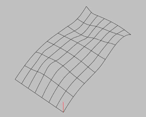

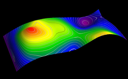

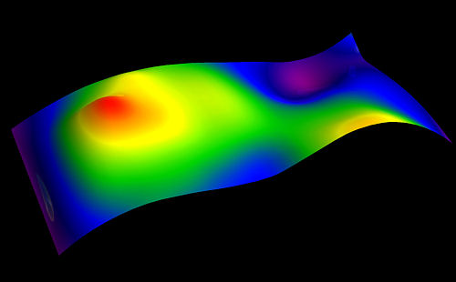

fahim108 Posted August 20, 2006 Share Posted August 20, 2006 Well, I was just doodling around in 2k7 the other day and found this odd way of making contour lines (and bands) on terrain models. Use the EDGESURF command to model the terrain surface, then map a texture on the XZ plane. That's it!... Note that the texture should, preferably, consist of horizontal color bands and/or horizontal lines to depict contours. By the way, can we change this EDGESURFd surface to sold without using the m2s lisp in 2k7? I am thinking of more weird possibilities now... :wink: Quote Link to comment Share on other sites More sharing options...

tzframpton Posted September 22, 2006 Share Posted September 22, 2006 i've used the EDGESURF command for awhile now... it's always cool to see what you can come up with.... basically it's just fun to 3DOrbit it around, see all the waves lol. james, textures are used to signify positive values in the Z axis over a plane.... if you've ever messed with Bryce this could show you more of what i'm talking about. now, i'm not 100% sure how Fahim did it, but i'm guessing this is how. lets say you use a black/gray/white texture, the black would be @0 Z, and gray would gradually make the mesh high, and all the way to white would make the mesh it's highest points. 3DS Max does this really well too, especially for transparencies, i used to mess with that a little in college, but never got too far into it. just had to do it for classes. once again, nice renders fahim.... keep 'em coming :-) Quote Link to comment Share on other sites More sharing options...
fahim108 Posted September 24, 2006 Author Share Posted September 24, 2006 Yup! Styk's right, I used EDGESURF in modeling those contours. But I don't think EDGESURF is the right solution for your problem... i.e. If you already have the contour lines. EDGESURF is used for blending/extruding the terrain "sections" not contours (planer). If you're working on 2K7, you may use the LOFT command. Make sure all your contour lines (splines) are "closed". Elevate these lines (to their respective heights) in 3D space, then use the LOFT command. Select the splines in lofting order. Hit enter. Regarding the texture, you can use any jpeg image having horizontal bands (or lines) and map it in XZ plane (keep the material "stretched to fit"). That's it! I recommend you start off with some basic shapes before doing it on this map. Please note, lofting may not work for split contours. Quote Link to comment Share on other sites More sharing options...

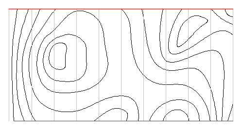

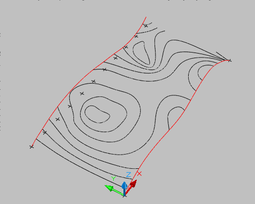

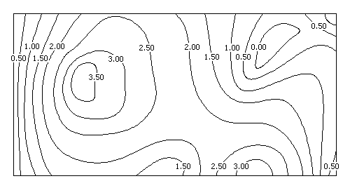

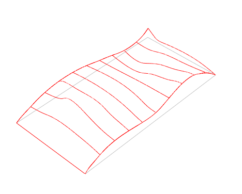

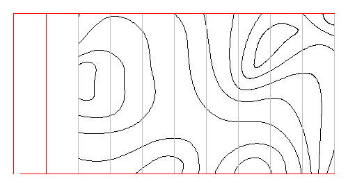

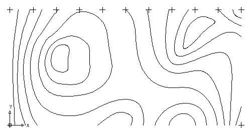

fahim108 Posted September 26, 2006 Author Share Posted September 26, 2006 What’s The Exact Procedure? Okay... So here's a detailed version of the earlier "tip" that I posted. I'm using 2k7 so am not sure if the other versions would support this... anyways, here's the procedure: Let's make out a 3D terrain out of the following contour map. Using the DIV command, divide the horizontal "border" of the map into 10 equal parts (for more accuracy use a higher value). Also, mark the four corners of the map for later reference. Delete the border. Elevate the contours (splines) to their respective heights in 3D space. You can use two viewports to do this, one displaying the plan, the other displaying the front view (or any side view). Select a contour line from the viewport showing the Planner view, then use the other viewport to move in Z-axis. Once all the contours are placed at their respective heights, use the SPLINE command to make out the perimeter of the terrain by joining the corners (earlier marked) with the elevated contours, as shown below (in red). Change the view to 2D wireframe (if it got altered), move to the planner view and draw the 11 vertical lines using the earlier 10 divisions (set the PDMODE value to 2 to make the nodes visible). Now use the TRIM command to shave-off the contours by the vertical lines. Make out a spline through these cut points (end points of the trimmed contours). Here, the vertical lines in red are the splines thus formed, while the second "slot" is being trimmed. Once all the trimming and "splining" is done, select all the splines. It should resemble the illustration shown below. When viewed in 3D, the above terrain looks like this: Now use the LOFT command to generate the wireframe into a 3D mesh. continued... Quote Link to comment Share on other sites More sharing options...

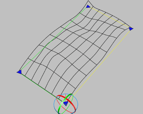

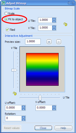

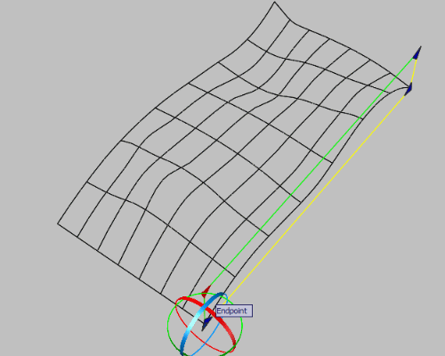

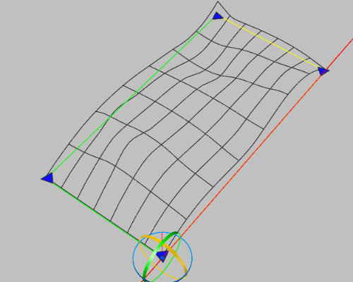

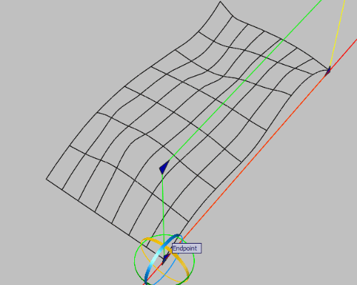

fahim108 Posted September 26, 2006 Author Share Posted September 26, 2006 And How To Map A Texture On It? Preferably in a 3D view, draw a reference line in the Z-axis measuring the highest altitude of the terrain. Use the MATERIALMAP command to start the mapping process. Use the Planer option and select the terrain. Enter T (to reset). The screen should look like this: Enter R (to rotate), move your mouse over the red circular band (to rotate along the X-axis). Once hovered, click on it and select the TOP End point of the previously drawn reference line. This would rotate the "map" along X-axis and place it in the ZX plane. Now move your mouse over the Top Left Grip of this MAP and drag it to the TOP END of the reference line. This would resize the map. Now hit enter. Choose any material consisting of horizontal bands (or lines) to depict contours. In the Adjust Bitmap window, make sure the "fit to object" option is checked. Apply the material to the terrain and render it. That's it! For a cross-check, I added horizontal lines to the actual material to verify the precision of the process and here's what I got... Very much impressive!! Quote Link to comment Share on other sites More sharing options...

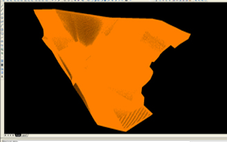

Gemma Elizabeth Posted January 9, 2008 Share Posted January 9, 2008 Hi there, Just doing a quick search to find out how to create a terrain. I have been using the edgesurf command to create the base in sections. The question really is how do I make it into a solid now? Here's an image, hopfully this might help. Quote Link to comment Share on other sites More sharing options...
