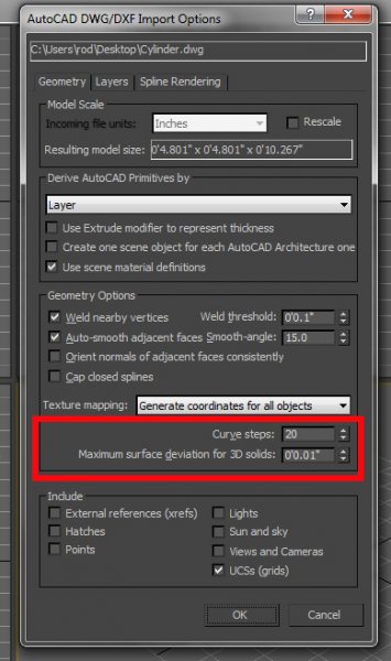

RSgraphics Posted June 26, 2012 Posted June 26, 2012 Hello all, I'm running into roadblocks trying to figure this out. Basically, I know Autocad pretty well. I build my 3D Models in Autocad as it is easier than using 3D Max. My plan is to then, export the 3D Autocad files to 3D Max Design for rendering. Here are some issues i run into. When i draw a simple DVD Disk (basically a circle with a little extrusion) in Autocad, then import it to 3D Max Design, the circle looks like its made up of just a handful of polygons. It doesn't appear as a smooth curve anymore. Can I please get some advice on importing 3D Autocad models into 3D Max Design? It's really getting me down at this point. Thanks in advance. Quote
Cad64 Posted June 26, 2012 Posted June 26, 2012 When I Import CAD models to Studio Max, in the "Import Options" dialog, I set "Curve Steps" to 20 and "Maximum Surface Deviation for 3D Solids" to 0.01". Quote
