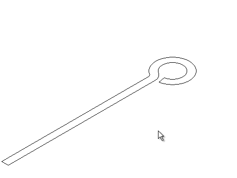

I'm a little bit confused about the steps of drawing a door hinge. I need to draw sth similar to.dwg file attached. I assume the "Subtract" command was used! what 3D object I should subtract from a shelled-cylinder!Any suggestions!
HINGE2.dwg
You could create that portion of the hinge simply from the 2D geometry and the use of the PressPull command.
Here is an approximation I quickly worked up.
Profile on the left. Result after PressPull on the right.

THANKS A LOT! I don't know why I wanted to make it complicated for myself:cry:! The video was awesome too! You made it easy for me!:D
... I don't know why I wanted to make it complicated for myself.

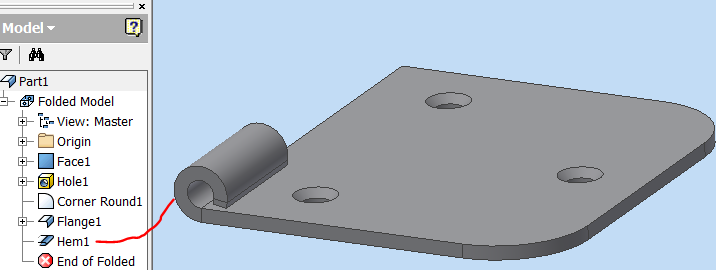

If you want to get really easy - Inventor has a tool to make this feature for you.
I just noticed that my picture is slightly different than the solution you were after - but one thing nice about Inventor is that it is easy to edit the change.
