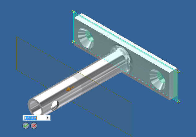

Here is an offset plane from a midplane.
Good Luck

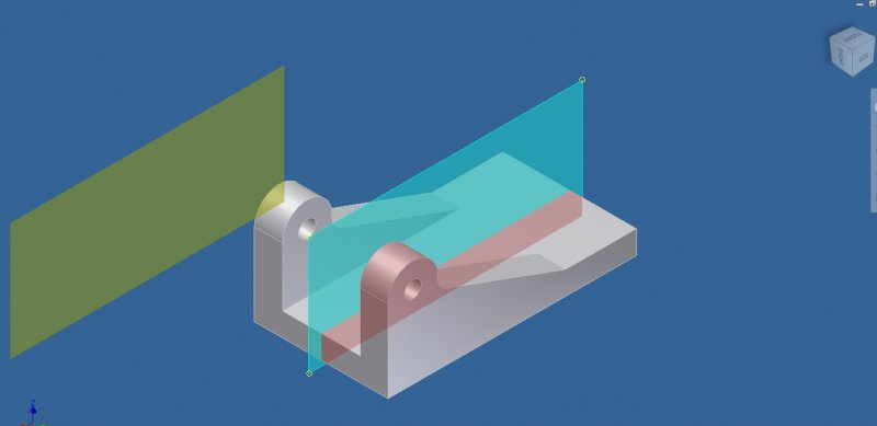

It's a part file. As you can see, I'm trying to offset the plane highlighted in blue. However, all I can do is only drag it around (i.e. the olive coloured plane), no dialog or anything for that matter.

You mention thicken/offset thats a surface modelling tool. You need a work feature.
Hi, thanks for the tip, but I don't have the drop-down option in Inventor 2010 (only have a Plane button). How do I access it?
You don't need that drop down.
Click the Workplane tool.
Click-hold and drag off of the existing plane. (always pick plane at edge, not middle)
You will be prompted for offset distance.
