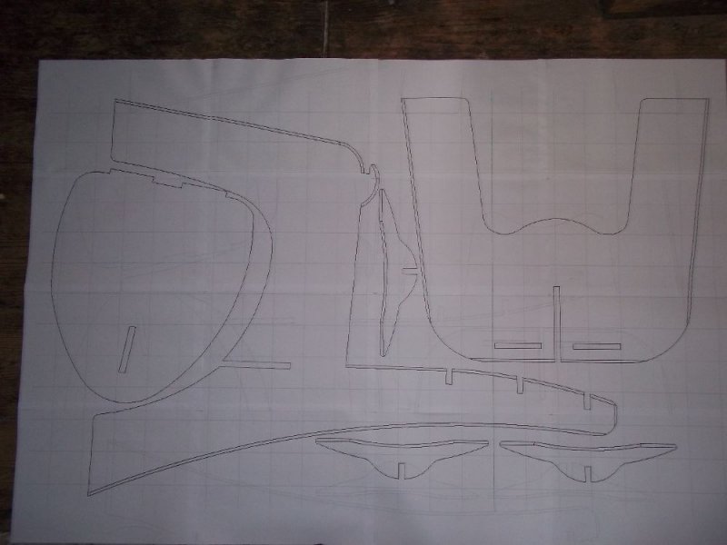

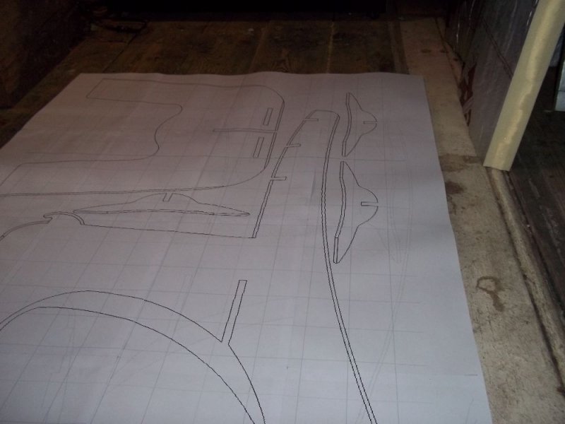

I've just printed the layout of the chair parts onto 16 A4 sheets...now is just a question of cutting the dotted margins and pasting the pieces together to get an A1.
The Poster Mode in my Canon is very basic...there is no accurate way to scale the object - 4x4 sheets = enlarged 4 times (as simple as that).
The first print wasn't accurately scaled (less than 4 times) because the drawing wasn't properly centered and the printer assigned its own scaling factor to fit the drawing in the sheets...this was resolved by double checking the margins and centering the drawing - now the scale is exactly x4 - so to obtain a 1:1 scale it is just a question of entering the scaling factor of 0.25 in Autocad (by clicking on the vport margin).

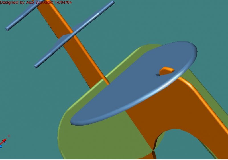

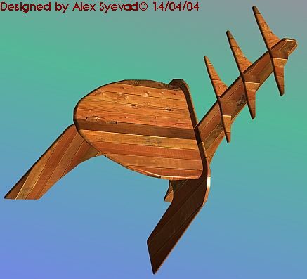

Can we see a copy of the drawing (in 3D) or at least an image? I'm curious as to what this chair looks like.
Right...here a picture of the chair in 3D and the actual A1 sheet (made by sticking together 16 A4s printed via my humble Canon MP610).
cutting and gluing the pieces together was relatively easy...but minute errors were accumulating and the final sheet got a bit misplaced - still, very useful and I'll get better with practice (never used Poster Mode in my printer before).
