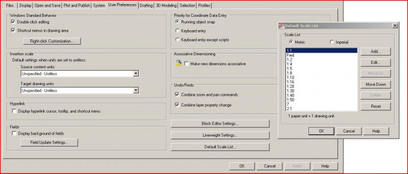

Should you ever want to confirm the default units of a template upon which you are working you can check it as shown in the image,
The default scale list will reveal whether you are working on a metric or imperial based template.
