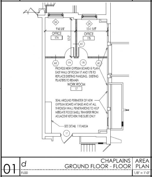

I am doing my bachelors in Civil Engineering and am currently working on an internship project. I am drawing a floor plan for a factory and the factory is currently in the process of construction. I have a few questions that have arise.
1) What are the CAD standards for a floor plan? What I mean by this question is that what are the standards for drawing a Garage Door, Doors, Windows, etc etc. How are these represented in CAD?

The best you can do is to grab some plans (full construction sets) and study them. Remember to make sure you detail your design intent. Here are some examples from a refit here...
Floor Plan:
Here you can see that the new walls are called out with a Hexagon with the wall style listed. Doors and windows are called out as well. Any notes about the room can be listed here as well. Let's look at the wall partition details.

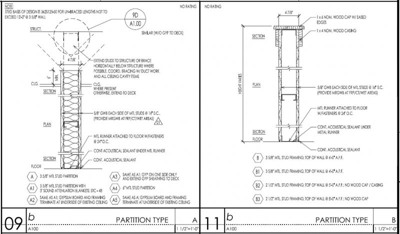

Wall Partition Types:
This calls out all types and sizes used in this project.

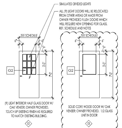

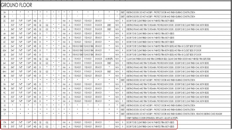

Door Schedule:
I highlighted the doors used in the area. We are using style 02 for this room. So let's look at the details.
Door Details:
Here we can see the size and style of door used with any notes needed.

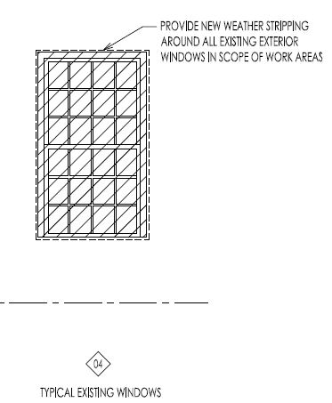

Windows:
Here we see existing windows but notes needed about the job and scope of work.
