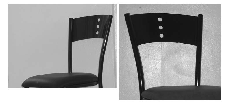

A steel plate is pressed to form an arc. Also notice that the bottom is narrower. How do I draw it in 3D? (If the plate is a perfect rectangle I would be able to draw it even if it is bent like an arc.)

I tried the SOLIDEDIT -> FACE -> TAPER and it worked for me. However, the real steel plate looks like this from the top (when you're standing next to the chair and looking straight down at it)
Notice that apart from the arc region, the steel plate is pressed at the left and right sides too. The reason for this is that it would be easier to weld the plate onto the steel tube, and it also adds strenght to the structure.
I can't seem to use the face-taper command on it, unlike the drawing that I made which is similar to Pockets' (right and left ends of the plate are NOT pressed).
Suggestions?:D
By the way I'm just a beginner so try to keep it simple and pretend I'm a moron.

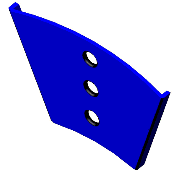

i dont think you need to use face/taper command. just extrude your arc section like stated above, and use the intersect command with another solid.
the face taper command will take the face of a solid and create a tapered face. Since you do not have a solid in that screen shot it will do nothing for you.
if you draw the back like above. you can draw the "ears" after and extrude them along a path(being the edge of your chair back).
let me draw something so you can see.
so i drew the back just like above. then i created the ear and a line that went down the side of the back so i could extrude along this Path. mirrored the ear and Union all 3 pieces together. then drew the holes in the back and did a fillet on them from the front side so it looks like an iron worked pressed the holes. to get the back to look accurate may take a little more work on your part if thats what you are aiming for though.
