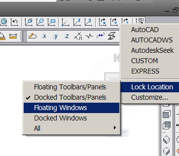

So, my command bar is stuck in the middle of my screen and it won't allow me to dock it at the bottom of the screen. Nor will it allow me to move or resize it(They're both grayed out.). Yes, the allow docking toggle is enabled and it does allow anchoring both left and right. Any suggestions. I've tried everything I could find through F1.

Is it Locked?
I haven't seen the option to lock it - But I'm assuming no seeing I am able to anchor it.
To learn more about locking UI components, look into the LOCKUI System Variable.
You can still anchor with it locked.
If the Command line is not docked/anchored, it's considered a "Floating Window" so my guess is that Docked Windows was unchecked but "Floating Windows" is/was checked.
