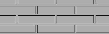

I'm often drawing to brick dimensions or block dimensions, and have my own grid that I drew, with alternating lines for the brick [215mm] and the mortar joint [10mm]. I xref it in when I'm drawing things to a block/brick grid.
I'm wondering if there's a way to set up a background grid to my DWG so I can snap to the grid and save time, but the grid would have to have - I suppose it's more of a 'plaid' grid if that's a clear way to put it, so a line at 0, 10, 225, 235, 450, 460, 675, 685, 900, 910 etc.

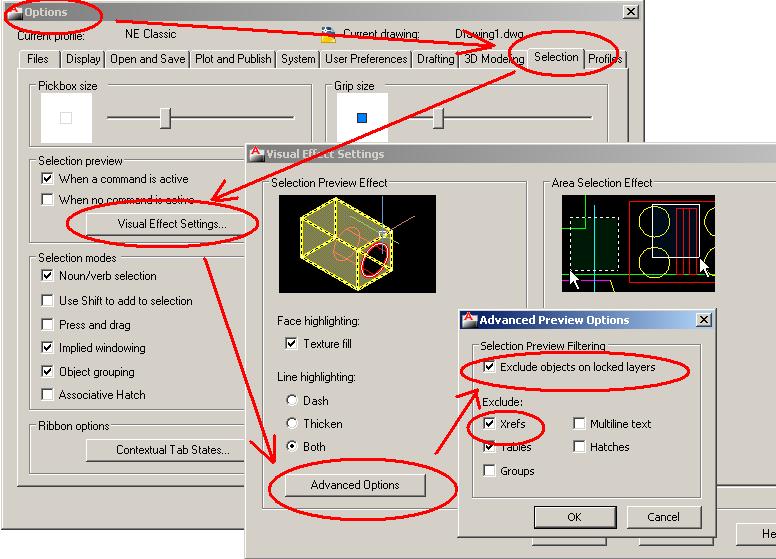

I usually bring the grid in as a block, and then have to lock the layer then turn off the setting that selects locked layers, so I'm not always highlighting the block when the cursor hovers over it [it's like a blimmin' disco if you don't do that]

Never used 2006... do you have anything that looks like this?
[ATTACH=CONFIG]35486[/ATTACH]
That's exactly what I use. Thank goodness LT allows you to do this; I have a lot of Xrefs loaded in a lot of drawings, it can get a bit ... oh, there's no emoticon for a twitchy eye. Maybe this one ;)
Altering the AutoCAD grid space doesn't work because you are also drawing the mortar joints. Is that right?
Yes, that's why I can't just set up a straightforward grid with 225 spacing.
This is the grid I Xref in, or bring in as a block. I think setting up a grid like this is impossible.
